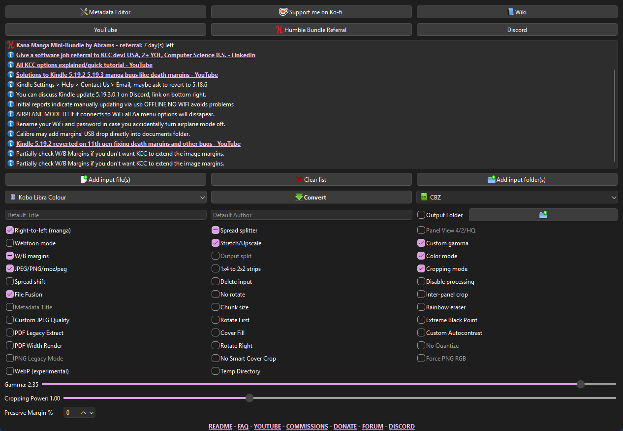

Hello!
I recently got a Libra Colour, and wanted to know what the best manga settings were when using Kindle Comic Converter to convert manga for the KLC. I have tried many options, but I've given up at this point. So if any of yall have genuine good settings with the KCC for manga specifically on the Libra Colour, I would love it if you could share with me.
Thank you in advance!!!
Something like this should be good enough. For custom gamma I'm sure there is a set number that people will use to make the contrast look better for manga but I'm unsure of what the number should be. If you don't like how some manga look you can always fiddle around with the custom gamma options. I saw some user mentioned that he adjusted the number to 2.50 for his Kobo Clara Colour which seems odd.
Hover over the spread splitter option and see which one you'd prefer more.

Also it won't edit my post for some reason but I would test the range of the custom gamma from around 1.20 to 2.50 in intervals of .10 or .20. Try it for one manga chapter/volume and see how it looks on your Kobo.
