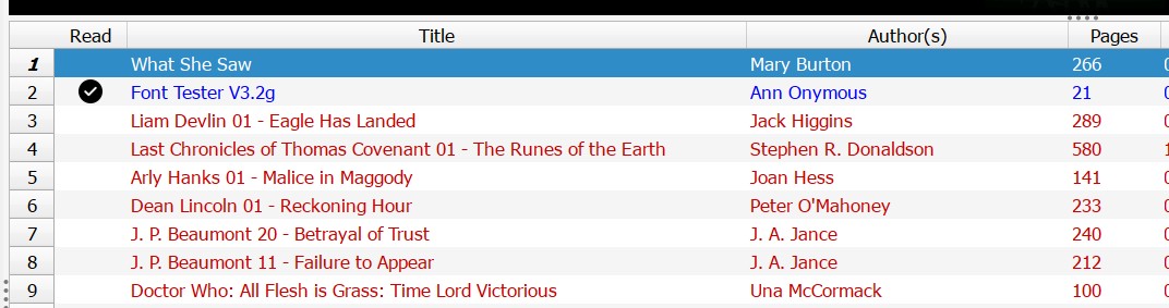

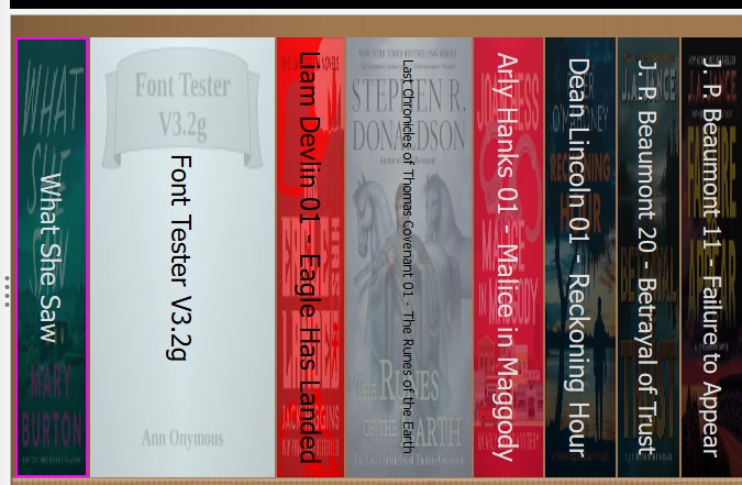

Another bug found. It seems the size of the covers is not quite correct. A cover for a book that has 21 pages is larger then a book that has 266 pages. And then that 266 page book is larger then the 289 page book. This either need to be fixed or make all cover the same width.
Attachment 220384 Attachment 220383
What is you template for spines width?
For that library, the template is {pages}.
So, one possibility is that, in waiting to have a valid page count, Calibre uses the file size to make an estimate as fallback. And given the name of the book, it would not be surprising if this book were very large and therefore the estimate were very high.
Check in the Bookshelf view preference tab if their still book in pending count. Once the full library is scanned and the size persists, we can see how it happen.
