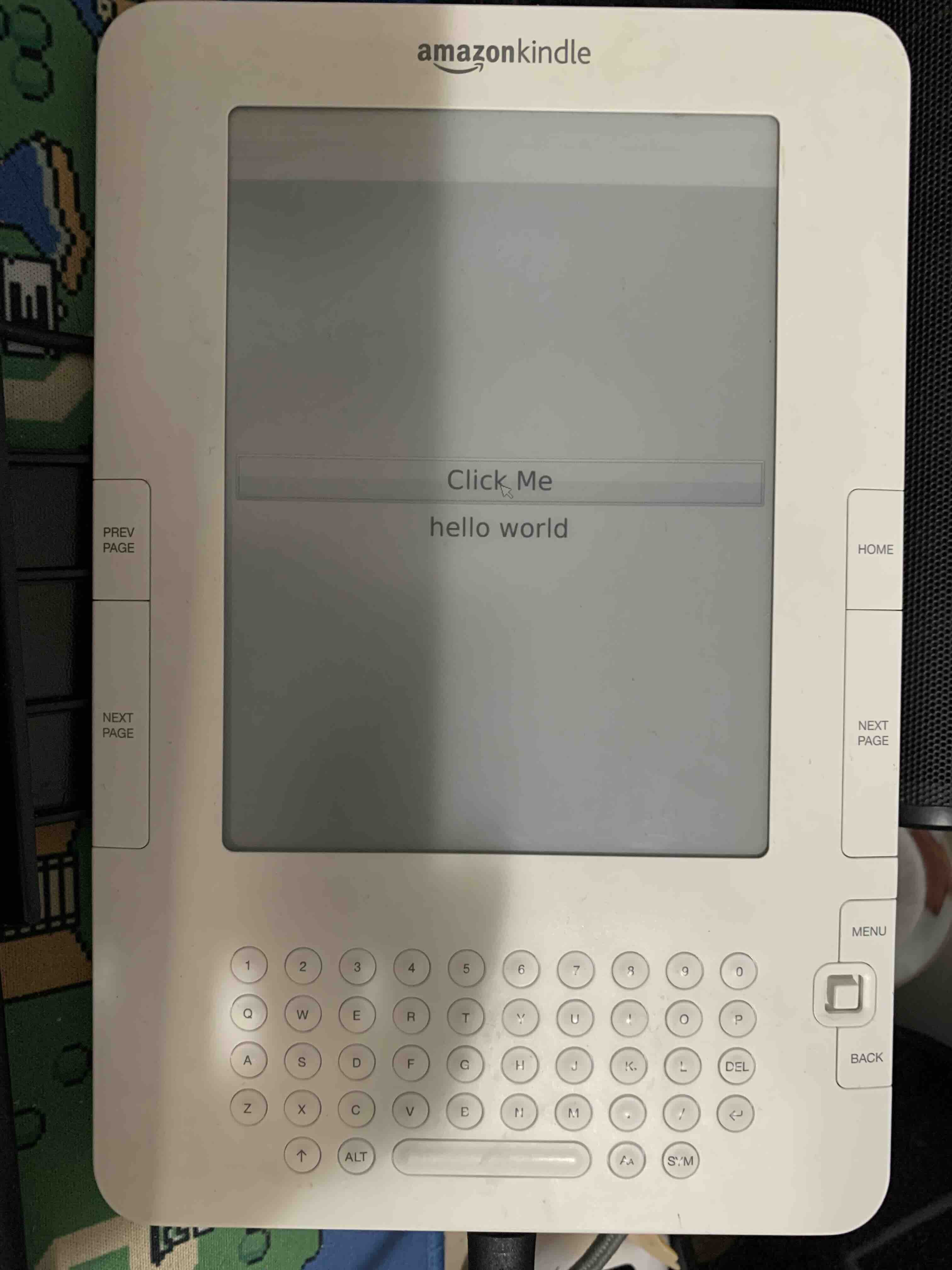

finally!!!!

Decided to nuke everything, and start the toolchain again from scratch. Dynamic linking works perfectly, Python -> Qt -> SIP -> PyQt
