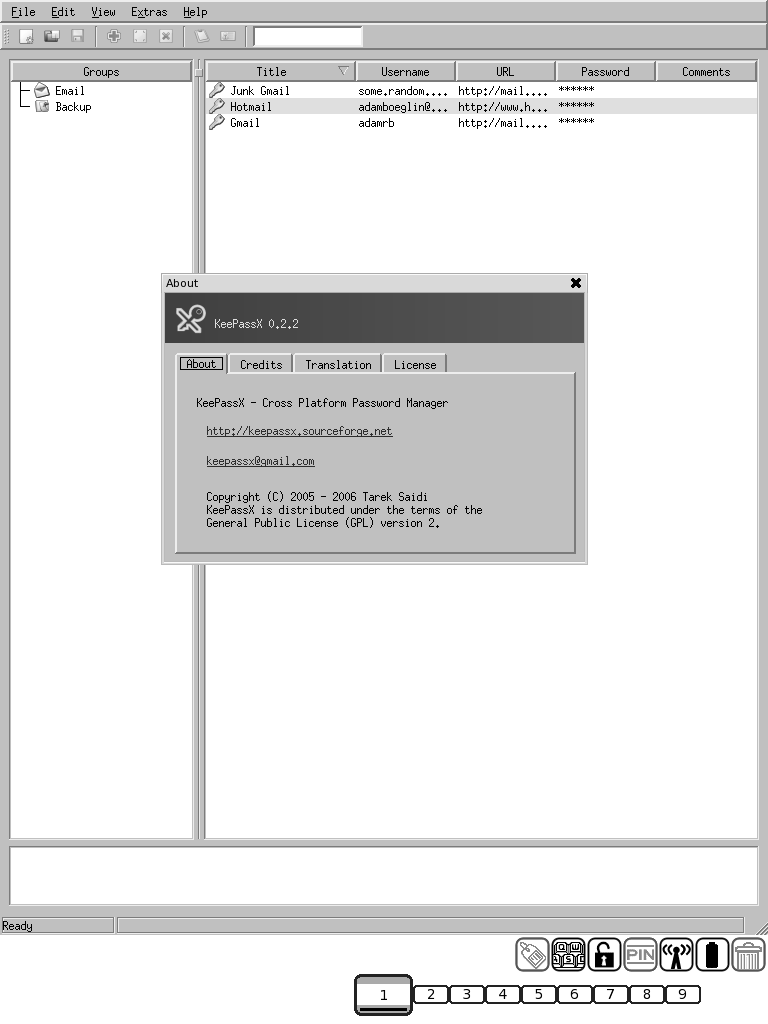

Yesterday, I decided that I really wanted KeePassX on my iLiad. It's a cross-platform program for keeping track of usernames/passwords for different websites. The problem is that it's written in QT4, which the iLiad does not include. I've never used QT before, but I thought I'd give it a shot. I had some problems compiling both QT and KeePass, but after some workarounds and hacks, I've got it working on my iLiad!
Right now, the font is almost too small to be usable, so I'll have to play with that. Also, packaging may be a pain, but we'll see how it goes. I'm elated that I've been able to get this far. Very, very cool.

Also, I'm very very interested how did you managed to compile Qt to iLiad, since some time ago I did a try and I've been not able to.
Did you used the Qt 4.2 libs or Qtopia? How did you managed the Qt X libs dependecy lack?

I used the QT 4.2.3 package.
I am, however running into the same problems that you did with libc. I was able to get all of the libraries compiled, but couldn't complete the builid process with some of the tools (qtconfig, etc). It works, and I can compile some programs against it, but it's not an ideal solution without the full QT Library.

Well, I got qtconfig to compile (had to use an old version, mix libraries, lots of fun ). Changing the font size has no effect. The font style and family is "fixed". This leads me to believe there's a problem with QT finding fonts on the iLiad. Perhaps I need to work with fontconfig...
"fixed" is the only bitmapped fiont installed in the iliad (and it is because X refuse to start if it doesn't have that).
Somehow you're not using the "client-rendered" ttf fonts that are installed. Perhaps bad paths in your compilation of fontconfig or in freetype... or whatever QT4 uses.
If you launch dillo, and then your app, you will see a lot of bitmapped fonts available. The dillo launch script registers some 100dpi fonts so that dillo, which is only able to use bitmapped fonts, can show reasonable nice web pages.

That did it! Once again, you save the day.
You guys can expect the first QT app release soon.
