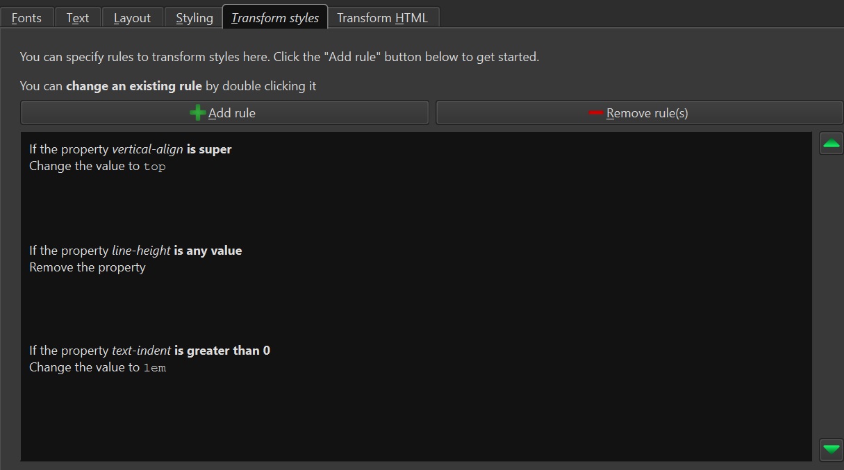

I don't have a stylesheet. I just use extra css and some style rules in the conversion option of calibre. And yes, most of the ebooks are poorly formatted. And for some ebooks I also use the edit option of calibre.
I have found the culprit for my ebook which refused to put some space after a chapter heading.
This is the code:
class="calibre_3"><a href="index_split_002.html#filepos1662"><span class="calibre2">CHAP*TER ONE</span></a>
Is this normal for a chapter beginning? The creator of this ebook included hyperlinks for every heading which brings you back to the beginning of the ebook when clicked. Never saw this before. But I handled it the oldschool way: search and replace the beginning of the chapter with the command <br>

Oh, right. You are trying to make all these edits using these rules in conversion dialogue.
Don't do that.
Open your epub in the Editor and make your edits there. Teach yourself how epub coding works, rather than that hit-n-miss approach in conversion. If you don't, you are always going to run into problems and unable to figure out why.
Even your comment "I don't have a stylesheet" is a major red flag issue. Of course you do, but you don't know what it is or where it is. So how can you possibly fix any coding issues?
So, go ahead, open the epub in the Editor and look at how an epub is built.
