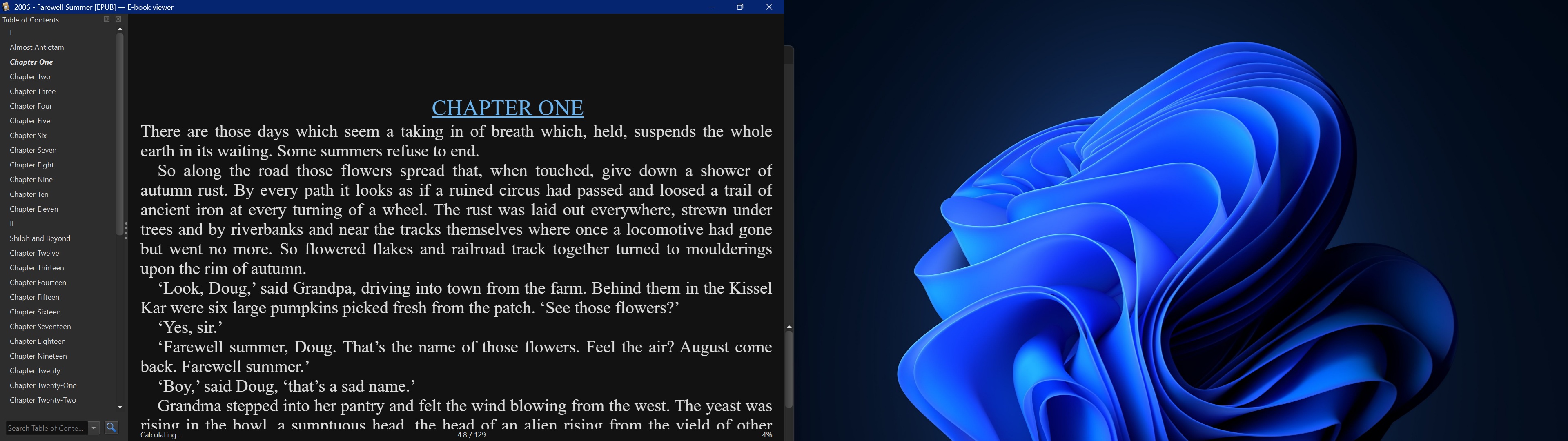

I have tested it with 10 ebooks which were poorly made and it still did a great job. Fantastic.
There is only one thing left now, sometimes the chapter title is just above the text without a space line. Is there something to fix that too? I know some ebooks use h3, some h1 for chapter headings. In order the get them all there must be something like:
h1, h2, h3 {
margin-bottom: 1.5em;
but that is not working sadly.

I don't have a stylesheet. I just use extra css and some style rules in the conversion option of calibre. And yes, most of the ebooks are poorly formatted. And for some ebooks I also use the edit option of calibre.
I have found the culprit for my ebook which refused to put some space after a chapter heading.
This is the code:
class="calibre_3"><a href="index_split_002.html#filepos1662"><span class="calibre2">CHAP*TER ONE</span></a>
Is this normal for a chapter beginning? The creator of this ebook included hyperlinks for every heading which brings you back to the beginning of the ebook when clicked. Never saw this before. But I handled it the oldschool way: search and replace the beginning of the chapter with the command <br>
