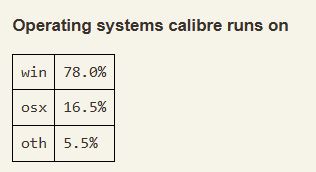

Originally Posted by Luna View Post
Could Calibre's large number of embedded frameworks (including Python.framework) trigger a macOS trust evaluation issue on certain system configurations? The direct executable bypasses this completely.
If there were issues... A lot of users would be howling. (see image just snipped)
Old 11-26-2025, 03:30 PM   #39
Posts: 22,462
Karma: 31000706
Not much use without the number of the active installs at the top of the page where you took your clip ==>> calibre - Usage Statistics for calibre
Active MacOS users = 476,239
Old 11-26-2025, 04:24 PM   #40
Posts: 50,734
Karma: 178402706
A bit of quick juggling of the numbers suggests that while ~476,239 people are using calibre on Macs, ~286,000 people are using calibre 8+ on Macs. I tend to agree that if it was an issue with most MacOS installs, the screaming would be loud.
