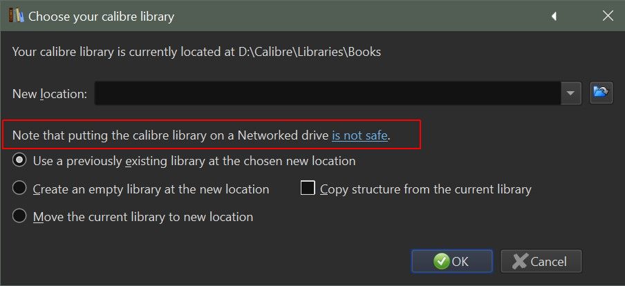

Where is the library:
If it is on a network drive, server, NAS, Cloud service or something similar (i.e. not a local device) my guess is you didn't see, or chose to ignore this?
Name:	Screenshot 2025-10-12 143932.jpg

You’re right I didn’t see that. It’s in my Dropbox. However I’ve loaded my library without a problem on numerous pc computers. This is the first time I’ve had a problem with this new Mac. Not sure if it’s just a coincidence. Is there anything I can do to restore it? All the files are there. Calibre just doesn’t seem to see them
