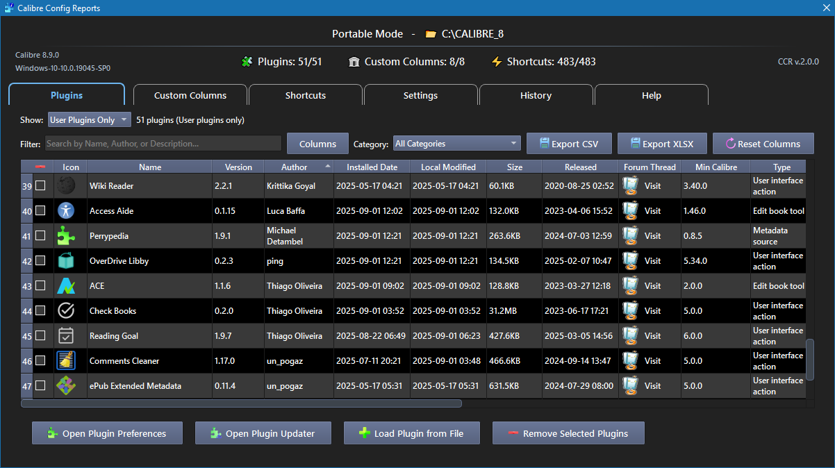

I have now uploaded version 2.0 with some new features. I'll add details later, see how it looks:
Name:	2025-09-03 21_04_02-Calibre Config Reports.png
Name:	2025-09-03 21_15_43-Calibre Config Reports.png
It can be installed from the zip in the first post:
https://www.mobileread.com/forums/sh...d.php?t=369555
Please try it out!

I'm testing on freshly installed out of the box portable 8.9.0. Prior to installing CCR I changed L&F Main interface to: small toolbar icons and two line tool bar labels.
Keyboard shortcuts is much better, now that all those pesky "None"s can be hidden.
  • Would it possible to show the default settings as a separate column, i.e. Assigned and Default.
  • If I double-click a CCR shortcut item the Shortcut editor pops, if I change any shortcuts when I return to CCR its shortcut list is not refreshed… IMO it should be.
  • If I press Enter on a CCR shortcut, it pops a Windows File Explorer window for the location from which I started calibre-portable… IMO it should do the same as double-click. Other panels are the same… actually it's worser, if I press Enter anywhere - even Help this FX window pops.
Name:	Screenshot 2025-09-04 150958.jpg
Still not seeing borders on the inactive tabs, do you have any Qt qss properties set or a customised colour scheme.
If an item on a list has focus the hardcoded Ctrl+Tab and Ctrl+Shift+Tab do not work. IMO they shouldn't be hard coded.
CCR History reports CCR reinstalled every time I invoke it:
Name:	Screenshot 2025-09-04 152231.jpg

Hmm, sorry I forgot the issue you had pointed out before about the Enter pressing.
The way I use the filter boxes is just typing letters or numbers to search something... until it displays the results, so I never press Enter in this case.
The profile/ portable path on the top of the dialog is clickable. This is meant to facilitate inspecting the config folder, but I believe that's what's triggering the Enter behaviour. I'm gonna fix that.
Good catch about the shortcuts not refreshing immediately. I just saw that I need to reopen the dialog. Thanks, I will fix that ASAP. (probably not today)
I will see if I can display the default shortcuts in a separate column. Definitely a good idea!
Regarding tabbing with the hardcoded shortcuts: I believe this could be a regression caused by the new multiple lines selection I implemented in the History tab... will take a look. I am also going to see if I can not hardcode the mentioned shortcuts and just noticed I need to add some for the Export actions.
Oh noes, that last CCR reinstall history repeat is definitely not correct, this will need an urgent fix.
I have attached my color palette file, please see if this solves the inactive border not showing (and I'm aware that I will need to provide a more effective solution for this in the future).
Note: I just noticed that when I export the Dark palette, the json contains also the Light one, which is not customized. I was expecting to export only the dark set of colors... Might ask in dev forum if this is by design.
