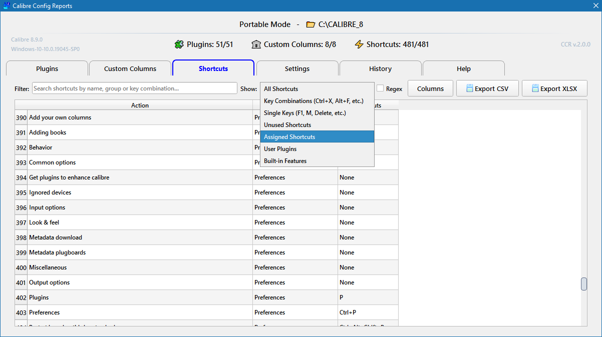

I have now uploaded version 2.0 with some new features. I'll add details later, see how it looks:
Name:	2025-09-03 21_04_02-Calibre Config Reports.png
Name:	2025-09-03 21_15_43-Calibre Config Reports.png
It can be installed from the zip in the first post:
https://www.mobileread.com/forums/sh...d.php?t=369555
Please try it out!

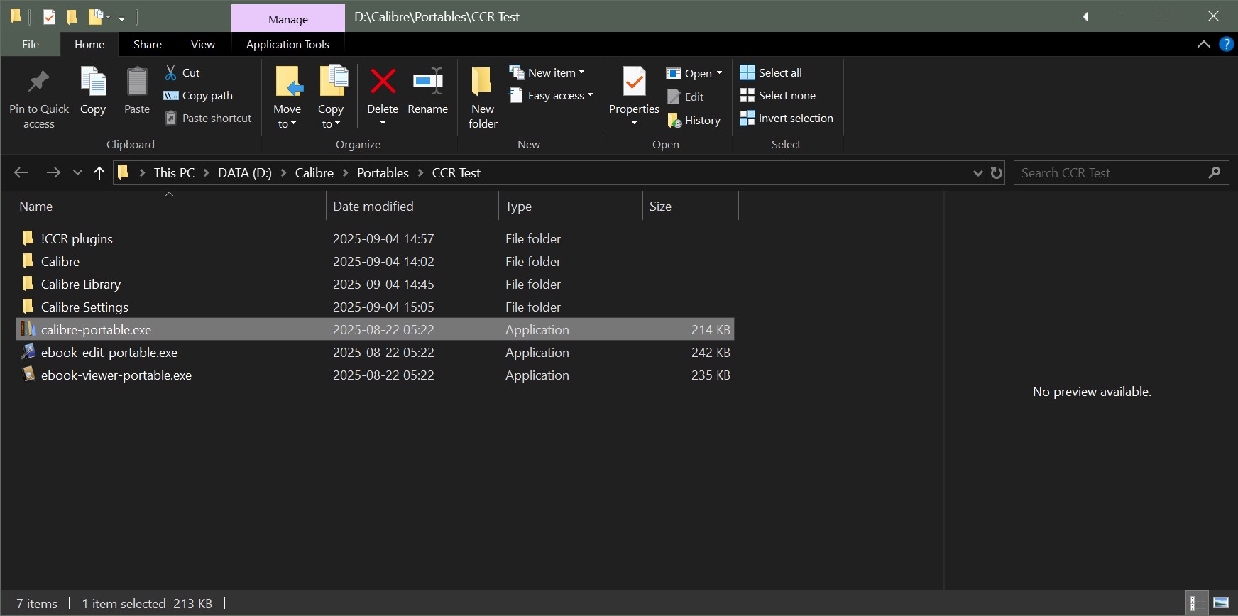

I'm testing on freshly installed out of the box portable 8.9.0. Prior to installing CCR I changed L&F Main interface to: small toolbar icons and two line tool bar labels.
Keyboard shortcuts is much better, now that all those pesky "None"s can be hidden.
  • Would it possible to show the default settings as a separate column, i.e. Assigned and Default.
  • If I double-click a CCR shortcut item the Shortcut editor pops, if I change any shortcuts when I return to CCR its shortcut list is not refreshed… IMO it should be.
  • If I press Enter on a CCR shortcut, it pops a Windows File Explorer window for the location from which I started calibre-portable… IMO it should do the same as double-click. Other panels are the same… actually it's worser, if I press Enter anywhere - even Help this FX window pops.

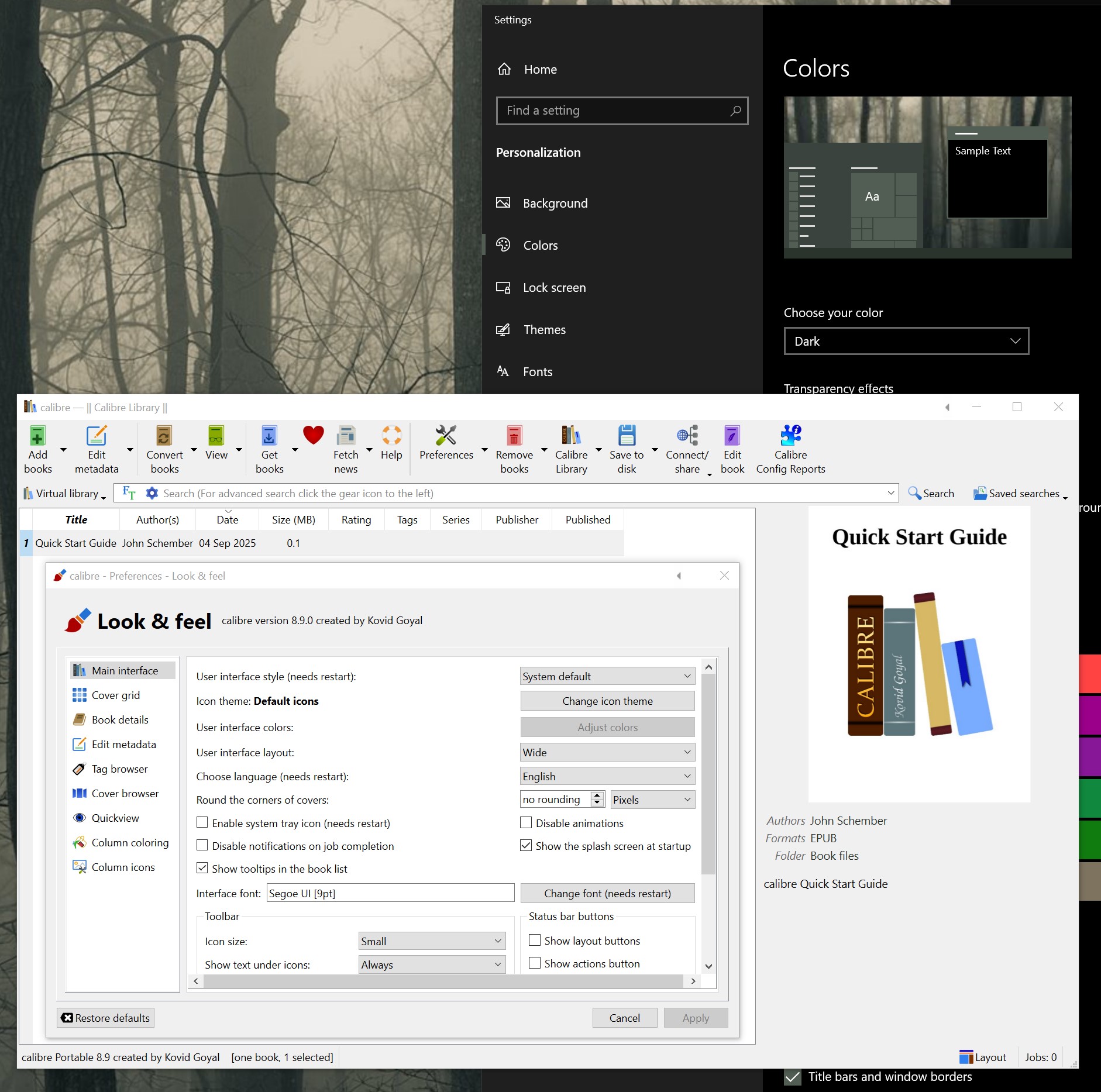

Still not seeing borders on the inactive tabs, do you have any Qt qss properties set or a customised colour scheme.

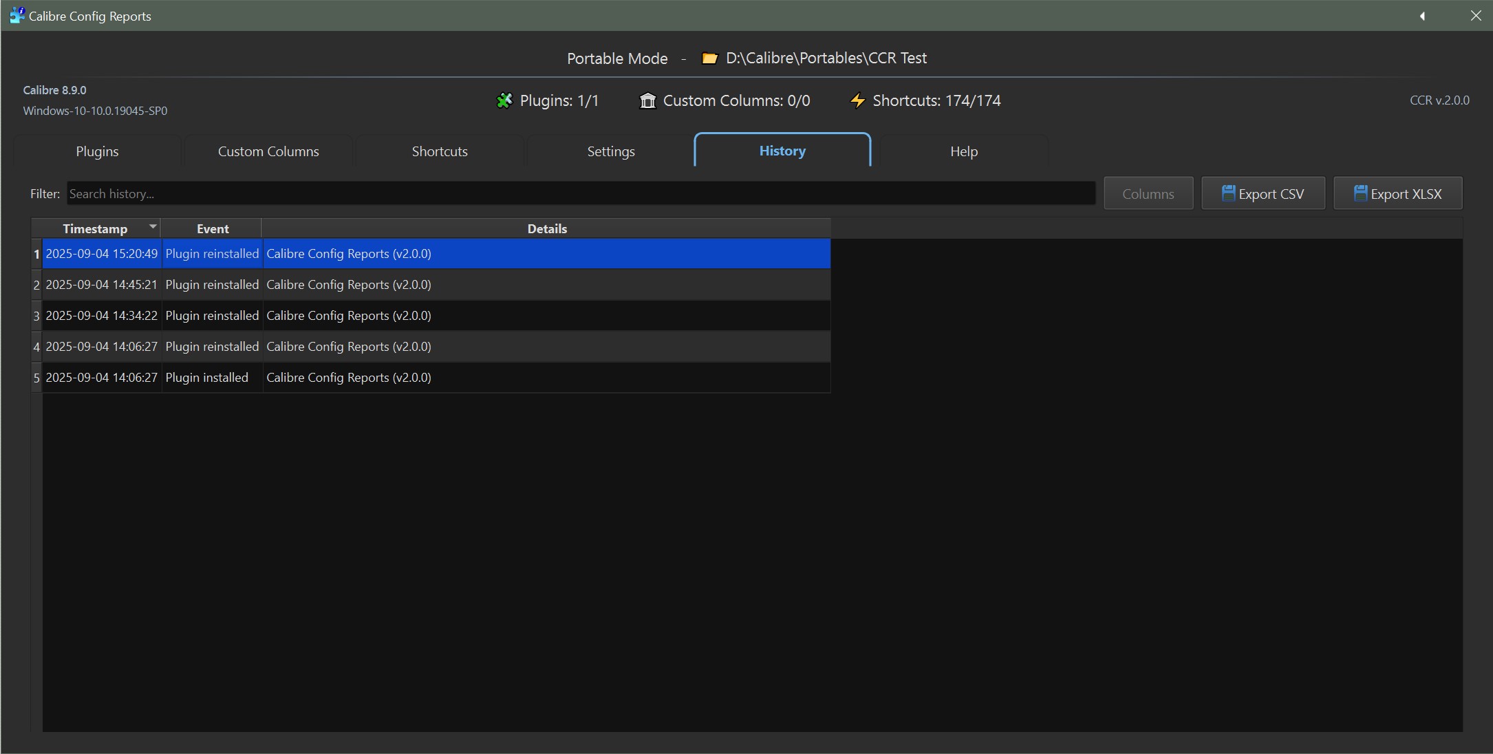

CCR History reports CCR reinstalled every time I invoke it:
Name:	Screenshot 2025-09-04 152231.jpg

Hmm, sorry I forgot the issue you had pointed out before about the Enter pressing.
The way I use the filter boxes is just typing letters or numbers to search something... until it displays the results, so I never press Enter in this case.
The profile/ portable path on the top of the dialog is clickable. This is meant to facilitate inspecting the config folder, but I believe that's what's triggering the Enter behaviour. I'm gonna fix that.

Oh noes, that last CCR reinstall history repeat is definitely not correct, this will need an urgent fix.
I have attached my color palette file, please see if this solves the inactive border not showing (and I'm aware that I will need to provide a more effective solution for this in the future).

What should I do with 040925-dark-zip ?
I suggest you put two buttons at bottom right - Open configuration folder and Quit and allow Enter to behave as it does most everywhere else in calibre - do what click or in some cases double click does.
Done! Please try version 2.0.1
Enter issues hopefully fully addressed

Nope - still no borders on inactive Tabs.
However I do get the borders on inactive tabs if I change User interface style to System default. But that forces calibre into Light Mode even though I have Windows set to Dark Mode.
Windows + Qt in this space is as obscure to me as Heidegger is on existentialism.
I am not bothered by the lack of borders on inactive tabs.
Name:	Screenshot 2025-09-04 183026.jpg
