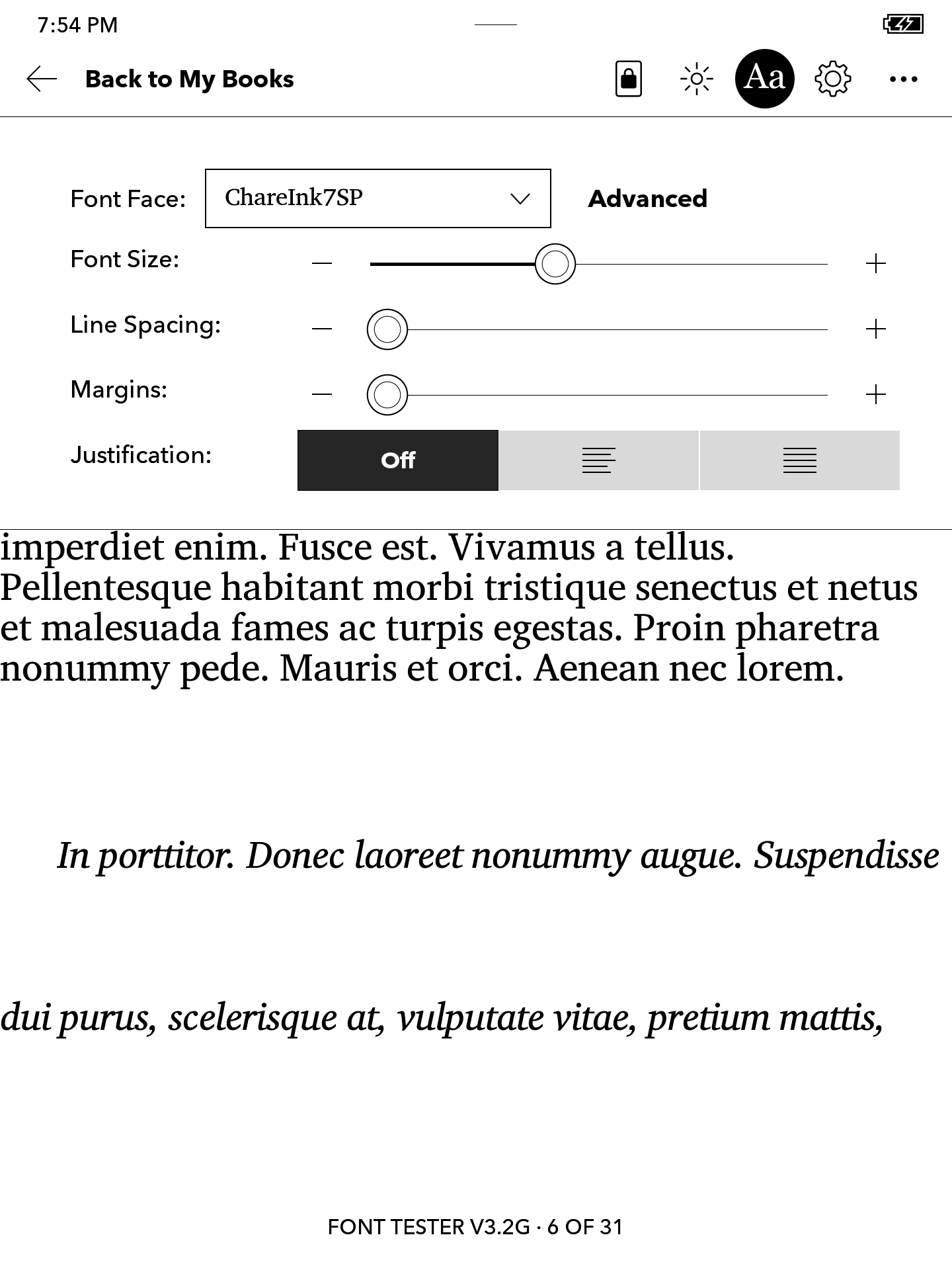

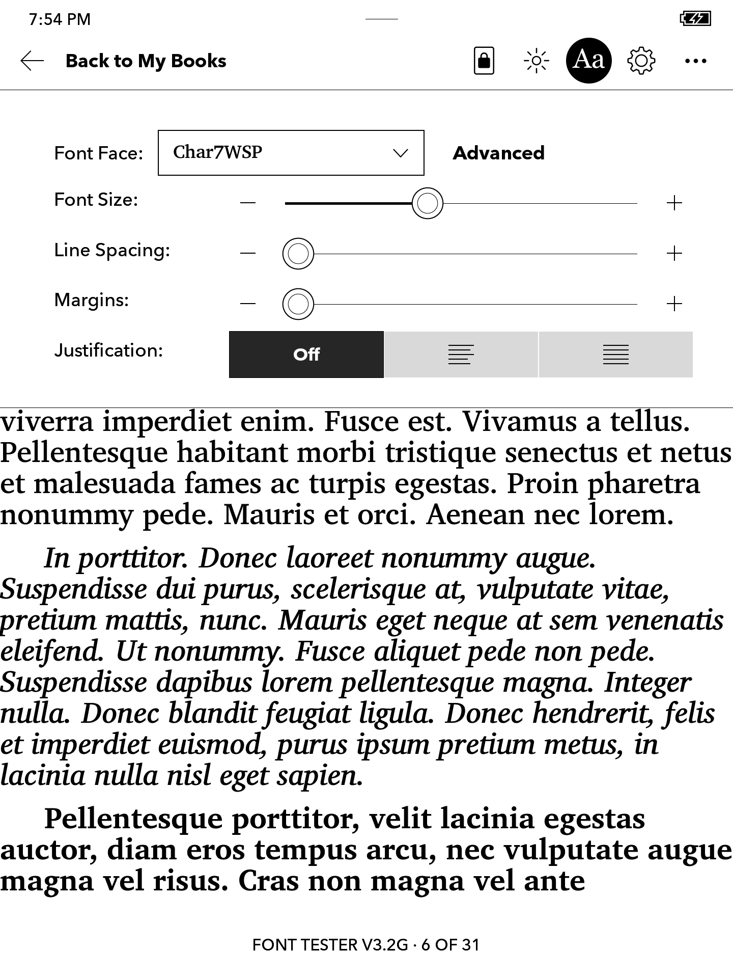

There seems to be an issue with the italic variant in the font. The line spacing is ridiculously large since the ascent is set to 15650 instead of 1650. The regular, bold and bold-italic variants look okay. See the attached image with my weighted variant and JSWolf's variant. I've also added my weighted variant for anyone who wants to try it. It uses the medium Charis version for regular and italic which I find comfortable to view.
Thanks for catching my mistake. I'll fix the italic version and repost.

Thanks to @DNSB, there was an error in the metadata of the italic version. That has been fixed. Also, I fixed the non-breaking space to mach the same size as the space.
