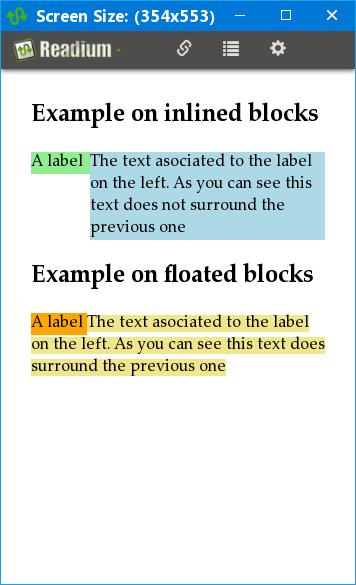

@RbnJrg - So, I'm still struggling to see the difference between float and in-line block. They boy seem to make the element "float". Is it that the formal "float" will only work in terms of floating all the way right or all the way left, whereas inline-block can "float" relatively throughout a given element?
Maybe this can help you:
  <h2>Example on inlined blocks</h2>
  <p><span class="col1">A label</span><span class="col2">The text asociated to the label on the left. As you can see this text does not surround the previous one</span></p>
  <h2>Example on floated blocks</h2>
  <p><span class="col3">A label</span><span class="col4">The text asociated to the label on the left. As you can see this text does surround the previous one</span></p>
.col1 {
  display: inline-block;
  width: 20%;
  vertical-align: top;
  background: lightgreen;
.col2 {
  width: 80%;
  background: lightblue;
.col3 {
  float: left;
  padding-right: 4px;
  background: orange;
.col4 {
  background: khaki;
However, if in .col4 you add the properties:
  float: right;
  width: 80%;
apparently they have a similar appearance. BUT the solution with "display: inline-block" keeps the blocks together (they have the "page-break-inside: avoid" property implicit), and that doesn't happen when the blocks are floating.
THIS is the explanation I was looking for. Thank you for articulating it so clearly!
Does this mean that two adjacent "inline-block" <p> elements will also want to run together?
Yes, they will. And if they are at the end of the page, and the user increases the font-size, the text inside the blocks won't break; both blocks will go to the next page. It won't have part of the text at the end of the page and part of the text at the start of the next page; all the text will remain joined.
With the floating method you can have similar results if you add the properties "page-break-inside: avoid", "break-inside: avoid" and "-webkit-column-break-inside: avoid" but all these properties are implicit in inlined blocks. But with one caveat: while the "display: inline-block" property is supported by virtually all e-readers (including ADE), the "page-break-inside: avoid," "break-inside: avoid," and "-webkit-column-break-inside: avoid" properties are not supported by all e-readers.
