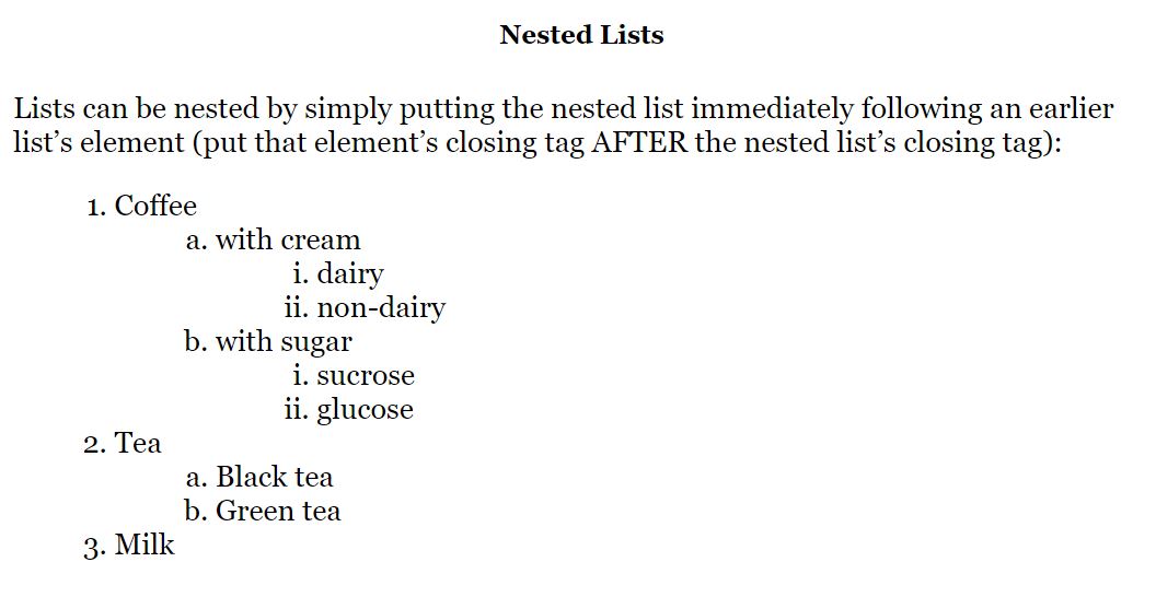

I could be misunderstanding what you're looking for. But, how about this?
Name:	20250626 -- Nested Lists.JPG
The HTML (keeping track of the various nestings of the ul and li elements is a pain in the Calibre Editor -- and EDIT: I mistakenly used the ul (unordered list) instead of ol (ordered list). But, it still seems to work.):
<p class="headline">Nested Lists</p>
  <p>Lists can be nested by simply putting the nested list immediately following an earlier list’s element (put that element’s closing tag AFTER the nested list’s closing tag):</p>
  <ul class="ol_arabic">
    <li>Coffee
    <ul class="ol_lowalpha">
      <li>with cream
      <ul class="ol_lowroman">
        <li>dairy</li>
        <li>non-dairy</li>
      </ul></li>
      <li>with sugar
          <li>sucrose</li>
          <li>glucose</li>
        </ul></li>
    </ul></li>
    <li>Tea
        <li>Black tea</li>
        <li>Green tea</li>
      </ul></li>
    <li>Milk</li>
  </ul>
The CSS:
.ol_arabic {
  /* Ordered List Class for Arabic Numbers (Safer to use UL) */
  display: block;
  list-style-type: decimal;
  margin-left: 1.2em;
  margin-right: 1.2em;
.ol_lowalpha {
  /* Ordered List Class for Uppercase Alphabetic "Numbers" (Safer to use UL) */
  display: block;
  list-style-type: lower-alpha;
  margin-left: 1.2em;
.ol_upalpha {
  display: block;
  list-style-type: upper-alpha;
  margin-left: 1.2em;
.ol_uproman {
  /* Ordered List Class for Uppercase Roman "Numerals" (Safer to us UL) */
  display: block;
  list-style-type: upper-roman;
  margin-left: 1.2em;
.ol_lowroman {
  /* Ordered List Class for Lowercase Roman "Numerals" (Safer to us UL) */
  display: block;
  list-style-type: lower-roman;
  margin-left: 1.2em;
enuddleyarbl is offline   Reply With Quote

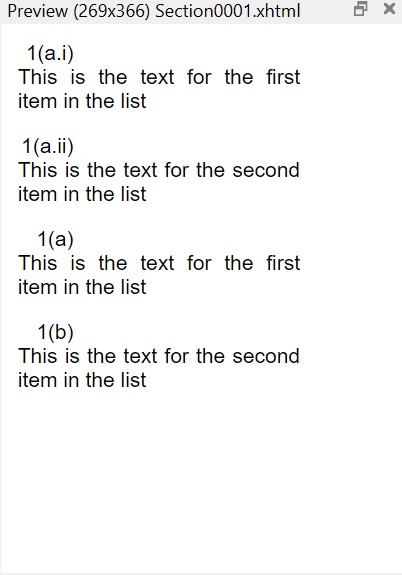

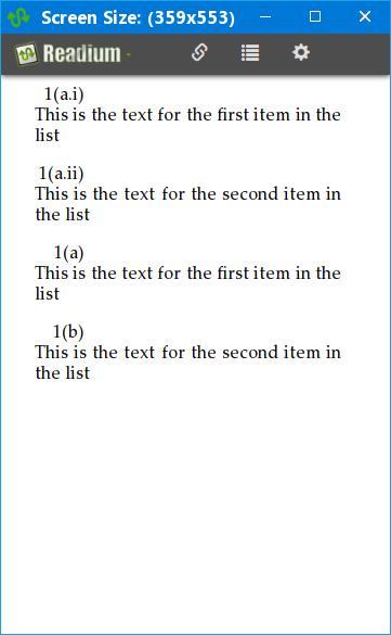

The solution by enuddleyarbl is very good but if you want to insist on your own list and numbering, use the following code, which is valid even for epub2:
1. In your .xhtml file:
  <p class="list"><span class="col1">1(a.i)</span><span class="col2">This is the text for the first item in the list</span></p>
  <p class="list"><span class="col1">1(a.ii)</span><span class="col2">This is the text for the second item in the list</span></p>
  <p class="list"><span class="col1">1(a)</span><span class="col2">This is the text for the first item in the list</span></p>
  <p class="list"><span class="col1">1(b)</span><span class="col2">This is the text for the second item in the list</span></p>
2. In your .css stylesheet:
p.list {
  margin: 0;
.col1 {
  display: inline-block;
  width: 15%; /* you can play with this percentage */
  padding-right: 10px; /* you can play with the padding value */
  margin: 0;
  vertical-align: top;
  text-align: right;
.col2 {
  width: 76%; /* you can play with this percentage */
  padding: 0;
  margin: 0 5% 1em 0; /* you can play with the margin-right percentage */
  text-align: justify;
Here you have a screenshot:
Take into account that the percentage of .col1 plus percentage of .col2 plus percentage of margin-right must be lower than 99% (because of the padding of .col1). Of course, this aproximation under epub2 is very sensitive to changing the font size. You can minimize this danger by increasing the size of the first column and reducing the size of the second. To get a dinamic layout to automatically change column widths as the font size changes, you need to work in epub3. Below you can check the respective epub2.

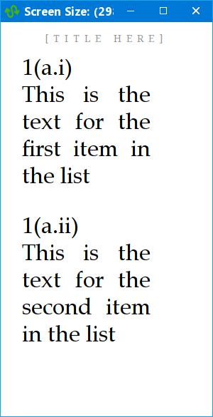

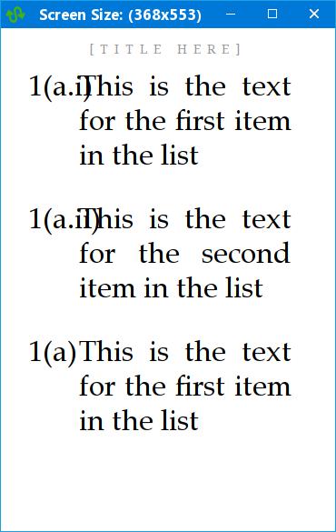

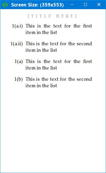

Thank you ennudleyarbl and RbnJrg for your help.
And yes, RbnJrg, that's exactly what I was looking for. I'm curious, though, how does the use of "inline-block" differ from float? That is, on the surface, they appear to be doing a visually indistiguishable thing here, but surely there's a subtle difference that I'm not catching. Is it the wrapping behavior of the two elements? I see that they detatch in the Sigil Preview window if it's narrow enough (presumably would do so on, like, a phone screen too), whereas the float (and table) css did not.
Also, is it necessary to define the width for the col2 span? I've tried toggling it on and off, and it doesn't seem to affect the wrapping behavior one way or another...
In order for the .col2 element (box) to be next to the .col1 element (box), you have to define a width for .col2 such that, when added to the width of .col1, it is less than 100%. As long as this is respected, unless the screen width is very narrow, .col1 will always have a width of 15% of the total width, while .col2 will have a width of 76%. However, if the user sets a large enough font size, the text in .col1 may overlap the text in .col2.
But as you appointed, if the screen width is very narrow, you can't avoid UNDER EPUB2, to get outputs like the following:
But set the width of .col2.

Yup. Just to be clear, the image i posted WAS with your original code (setting width to 76%). BUt as you say, with a narrow screen it'll split.
