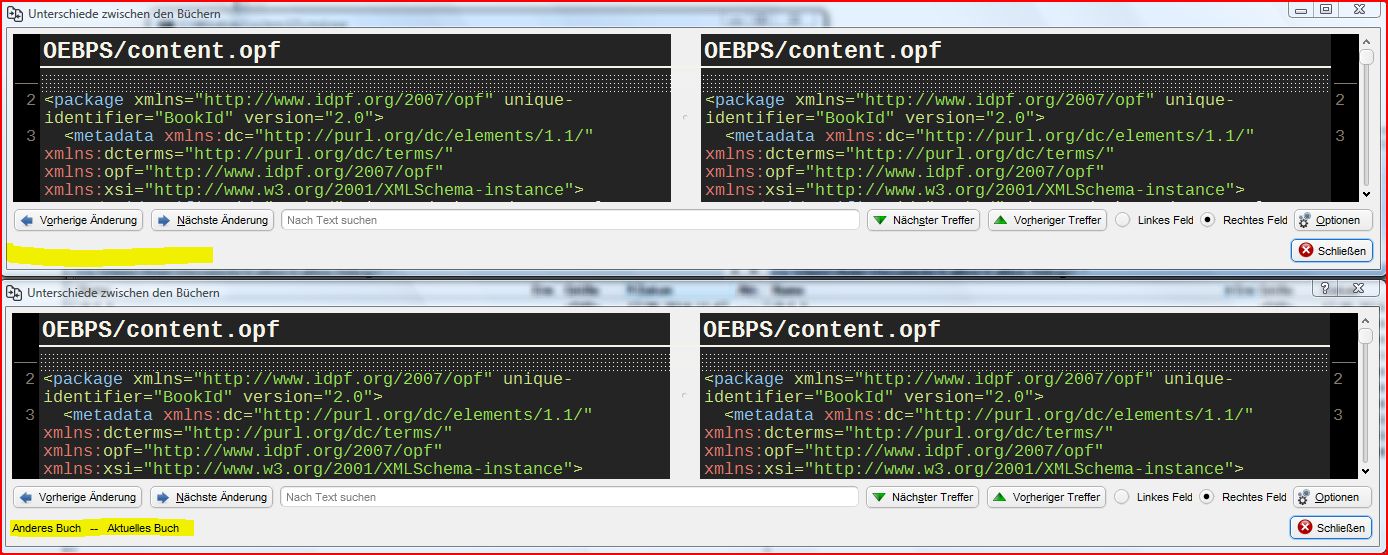

Finally, I recognize a different behavior at the bottom of the window for the information line (pls. see picture, first part is via command line and below part is via editor).You show the information about which files are part of the comparison if I open the diff tool from the editor. This is missing if I open the tool via command line.

The diff tool does not work only for epubs, but for all file types. I even use it as my primary code diff tool for developing calibre. The necessity for adding -- before the filenames is actually a bug, which has been fixed for the next release, which is why the translation string changed.
