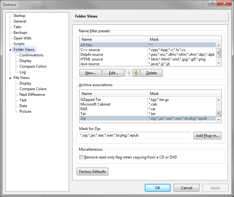

@OddCosine: You do not even have to "fake" the file extension for BeyondCompare, just add "*.epub" to Tools->Settings->General (Archive Associations) and BC will know from then on how to handle epubs.

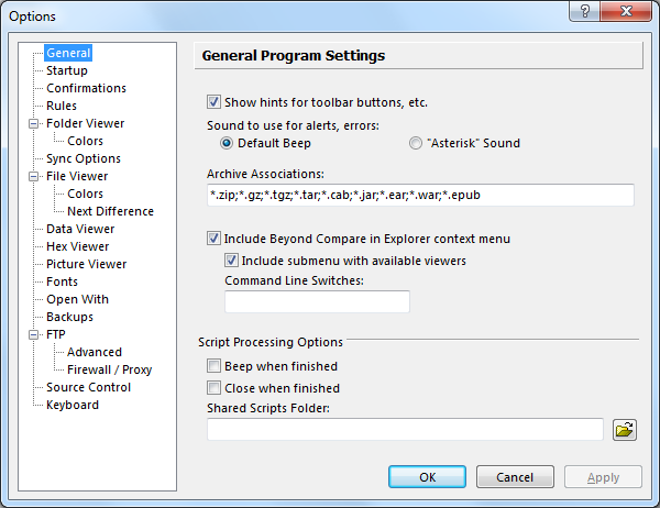

That's actually what I meant, but I see you already know how to do it. Mine is set a little differently though - it looks like we have different versions of BC (I have 3.3.7).
