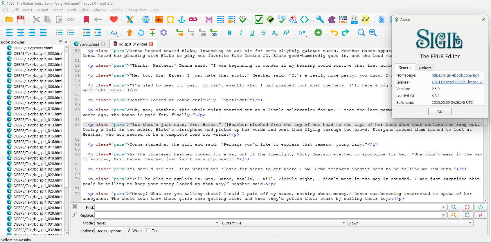

New compiles of Sigil and PageEdit. The cursor seems to be on the start of the line selected in Sigil's CodeView when PageEdit opens but a lot easier than scrolling through multiple lines.
Edit: added screenshots of Sigil and PageEdit. I placed a [] where the cursor was in Sigil before opening PageEdit and where the cursor showed in PageEdit.
Name:	Screenshot 2025-05-08 223233.png
ID:	215578   Click image for larger version
Name:	Screenshot 2025-05-08 223138.png

Yes, that is expected behaviour as navigating is based in the nearest containing tag. For most text that will be the p tag that holds it.
Unfortunately when live editing html, Chrome can split text nodes and inject text nodes causing the dom to need to be re-normalized constantly. When you add to that whitespace can be compressed, offsets in text strings become an issue. So for consistency we take you to the closest destination we know will exist: the parent of the text.
This is how Preview navigates to where you click in CV, and visa versa.
