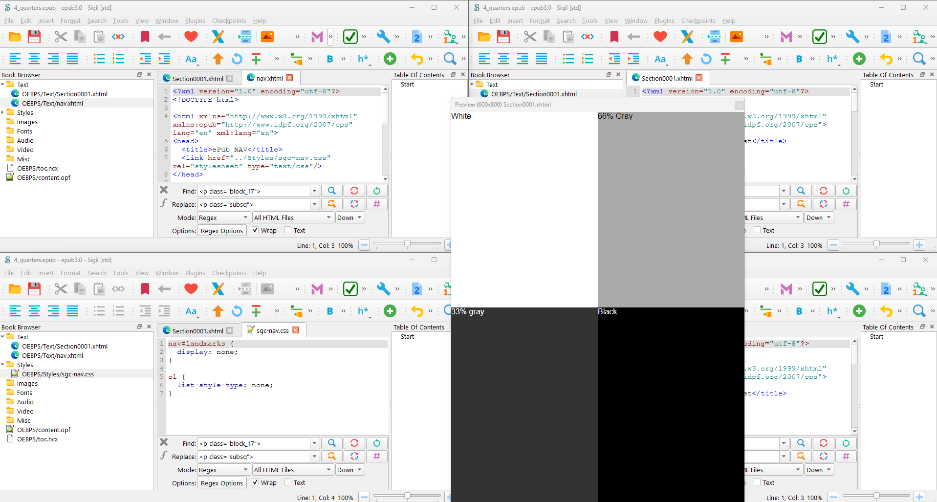

I tried that modification and it worked! I launched 4 Sigil instances and they were happy campers.
Name:	Screenshot 2025-04-25 225043.png
