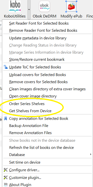

Originally Posted by notesurfer View Post
Could that function have been moved somewhere else? Because the current Kobo Utilities plugin doesn't appear to have anything labeled shelves, collections or anything similar that I can see.
There is an item "Get Shelves from Device", if you right-click on the plugin icon.
A little bit strange. The current version of Kobo Utilities is 2.21.1 and shows all options even those not supported in the current firmware though they will be greyed out. The two Shelves items are definitely visible. See attached image.
Name:	Screenshot 2025-04-04 204111.png
