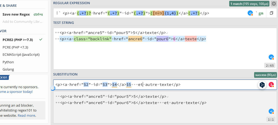

Good morning,
Yes the spaces are due to the fact of the multiple copy-paste between the word processor, the translator and the absence of a code block.
In fact I was wrong, I thought it worked under Regex 101, because it automatically copies in the substitution area, I had not been careful. But in fact it is like in Sigil, it only finds with an occurrence of the chain, while I ask with or without.
I would have liked, as far as possible, with the same regex (because of course, I could treat in 2 passages):
- Find all links; Whether or not this first channel is (class or other)
- be able to modify, for example group 5 of all links
- Do not postpone the channel \ 1
The quantifier ? (0 or 1), only finds 1
the quantifier * (0 or more), does not match
The quantifier {0.1}, only finds 1
Thanks

Good morning,
If it can help on what I'm looking for, I have another example of a random presence of a chain. Here, I have or not (0 to several times) the presence of the insessable space.
In this case I therefore use the quantifier *, and in this case, where the chain is not at the beginning, Sigil or Regex 101 finds and deals well with the 4 links.
Thanks

Hello Haudek,
Thank you for taking the time to help me.
We are, through my fault, encountering comprehension problems.
I never meant inconsistency, but inconstancy (translation?).
I'd like to make it clear that there's no problem with the spacing and that it was only due to the fact that I'd mismanaged (the senility of my 73 years no doubt...) the copy-paste between the different editors.
Let me start from the beginning.
I was showing an example that works, where in links, I have the inconstant presence of a character string (in this case the unbreakable space). Inconstant in French, which means that sometimes there are (from one to several), sometimes there aren't, as in :
<p><a href="anchor450" id="for450">450</a>Text1</p>
<p><a href="anchor451" id="for451">451</a>*Text2</p>
<p><a href="anchor452" id="for452">452</a>**Text3</p>
<p><a href="anchor453" id="for453">453</a>***Text4</p>
I was saying that with a capturing group and the quantifier "*" - star, asterisk - (0 or more), I could process all links, even the one where the required string (one or more non-breaking spaces) is absent (empty, null).
To research:
<p><a href="(.*?)" id="(.*?)">([0-9]{1,4})</a>(*)*(.*?)</p>
To replace:
<p><a href="\1" id="\2">\3</a>\5  something else</p>
Treats all 4 links well:
Result:
<p><a href="anchor450" id="for450">450</a>Text1  something else</p>
<p><a href="anchor451" id="for451">451</a>Text2  something else</p>
<p><a href="anchor452" id="for452">452</a>Text3  something else</p>
<p><a href="anchor453" id="for453">453</a>Text4  something else</p>
You suggested another regex, which also works.
<p><a href="(.+?)" id="(.+?)">([0-9]{1,4})</a>[(*)+]*(.+?)</p>
But I have no problem with this one. The quantifier on the searched group works and I agree:
- we could use a [\d+] notation
- we could use a non-capturing group (?: ...) and shift the \x
So here's the problem.
Let's say I have a group of links, with a string that may or may not be present. Either (0 or 1).
So, of course, I could deal with this in several passages, I could always manage, that's not the problem. But intellectually, it's still bothering me (I don't know how it's going to be translated... ,-) ).
Here, it's a class, but this string could be something else (epub:type="noteref"), etc.
<p><a href="anchor451" id="for451">451</a>Text2</p>
<p><a class="backlink" href="anchor452" id="for452">452</a>Text3</p>
<p><a class="backlink" href="anchor450" id="for450">450</a>Text4</p>
So I tried a capturing group from an unknown string, but placed there, with the quantifier "?" (0 or 1).
To research:
<p><a (.+?)? href="(.+?)" id="(.+?)">([0-9]{1,4})</a>(.+?)</p>
To replace:
<p> href="\2" id="\3">\4</a>\5  something else</p>
Unsuccessfully, unlike the example of non-breaking spaces above, I can only find links in which this string is present. The string (class...) has been removed, but it's clear that the text has only been modified in links with this string.
Result:
<p><a href="anchor450" id="for450">450</a>Text4  something else</p>
If I try the capturing group with quantifier {0,1}.
To research:
<p><a (.+?){0,1} href="(.+?)" id="(.+?)">([0-9]{1,4})</a>(.+?)</p>
To replace:
<p><a href="\2" id="\3">\4</a>\5  something else</p>
Result:
I get the same result. I only catch links where the string is present.
If I try with the quantifier "*" (0 or more), then 1 is possible.
To research:
<p><a (.+?)* href="(.+?)" id="(.+?)">([0-9]{1,4})</a>(.+?)</p>
I'm not capturing anything!
After your posts, I also tested a non-capturing group, with the same result. Only links to the chain are matched.
To research:
<p><a (?:.+?)? href="(.+?)" id="(.+?)">([0-9]{1,4})</a>(.+?)</p>

Newest regex:
<p><a(?:\s+\w+="[^"]*")*\s+href="(.+?)"\s+id="(.+?)">([0-9]{1,4})</a>(?:\s)*(.+?)</p>

Good evening Haudek,
Perfect, it works very well.
I understand the regex you gave me:
- a non-capturing group
- the secure management of spaces (\s+).
- 1 or more characters (\w+) up to the = sign
- between quotation marks, a set (from 0 to several) of characters, except for a quotation mark
- the non-capturing group, present from 0 to several times
but I'd never have thought of something like that. What's more, the quantifier “?” (0 or 1) works with it!
Would you have an explanation, not too learned for me, as to why the formula (.*?)? only works when the chain is present, whereas the quantifier says (0 or 1)?
I've made a note of how to do this for images and HTML entities, for another time.
Thank you very much.
