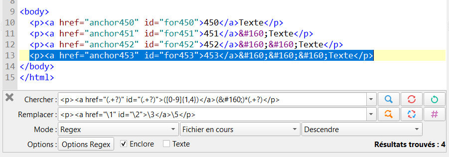

Good morning,
Yes the spaces are due to the fact of the multiple copy-paste between the word processor, the translator and the absence of a code block.
In fact I was wrong, I thought it worked under Regex 101, because it automatically copies in the substitution area, I had not been careful. But in fact it is like in Sigil, it only finds with an occurrence of the chain, while I ask with or without.
I would have liked, as far as possible, with the same regex (because of course, I could treat in 2 passages):
- Find all links; Whether or not this first channel is (class or other)
- be able to modify, for example group 5 of all links
- Do not postpone the channel \ 1
The quantifier ? (0 or 1), only finds 1
the quantifier * (0 or more), does not match
The quantifier {0.1}, only finds 1
Thanks

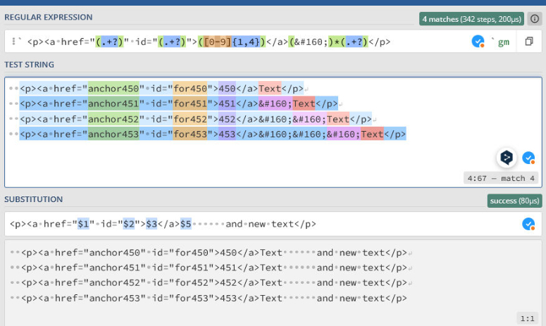

Good morning,
If it can help on what I'm looking for, I have another example of a random presence of a chain. Here, I have or not (0 to several times) the presence of the insessable space.
In this case I therefore use the quantifier *, and in this case, where the chain is not at the beginning, Sigil or Regex 101 finds and deals well with the 4 links.
Thanks

Screenshots you can post as attachments. You can do that by "Go Advanced" and clicking the paperclip icon, to add an attachment.
<p><a href="anchor450" id="for450">450</a>Texte</p>
<p><a href="anchor451" id="for451">451</a>&#160;Texte</p>
<p><a href="anchor452" id="for452">452</a>&#160;&#160;Texte</p>
<p><a href="anchor453" id="for453">453</a>&#160;&#160;&#160;Texte</p>
My regex:
<p><a href="(.+?)" id="(.+?)">([0-9]{1,4})</a>[(&#160;)+]*(.+?)</p>
Is this what you were looking for?
Haudek is offline   Reply With Quote

Hello Haudek,
Thank you for your answer.
I am looking for a solution for the post above. This one was just an illustration, to explain myself well, to show that I managed to find an inconsistent chain in this example. And my regex:
<p><a href="(.+?)" id="(.+?)">([0-9]{1,4})</a>(.+?)*(.+?)</p>
Like yours:
<p><a href="(.+?)" id="(.+?)">([0-9]{1,4})</a>[(#160;)+]*(.+?)</p>
Find 4 positive results here.
My problem is in the preceding post, where I cannot manage this famous inconsistent chain (Class="Blacklink").

I don't know how to do it, it replaces the HTML code for non-breaking spaces with asterisks.
And how did you manage to put the images like that? Did you turn them into attachments?

Newest regex:
<p><a(?:\s+\w+="[^"]*")*\s+href="(.+?)"\s+id="(.+?)">([0-9]{1,4})</a>(?:\s)*(.+?)</p>
If you want to write &#160; then mark “&” and bold this character. Then the parser will not treat this notation as an entity. It adds a bit of work when writing the post, but for later when copying there is no problem. Instead of bold, you can use something else (italics, different color, etc.).
I don't know if this is the correct way, but it can be done like this:
1. From the toolbar, you select the paperclip.
2. You add an attachment.
3. After adding an image attachment, you close the "Manage Attachments" window and select the arrow next to the paperclip.
Now all you have to do is select the appropriate image and [ATTACH]NUMBER[/ATTACH] will be inserted in the post code.
Done.

Good evening Haudek,
Perfect, it works very well.
I understand the regex you gave me:
