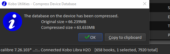

Running from current source seems to work. Unless I misunderstoood?
Name:	2025-03-10 07_20_41-Window.png
Attachment 214244
Yeah, it currently works because the plugin falls back to its own connection. I meant that if I wanted to make use of the new DB methods then it wouldn't work any more for this case.
