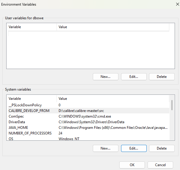

I run calibre from source most of the time however I wanted to test an issue and so changed the variable name to not run from source. This worked until I closed calibre. The next time I opened calibre, it ran from source. I check the environmental variables and the variable name was unchanged however when I ran set from the command line, it showed both the original and modified variables.
Is this expected behaviour?
CALIBRE_DEVELOP_FROM=D:\calibre\calibre-master\src
DNU_CALIBRE_DEVELOP_FROM_DNU=D:\calibre\calibre-master\src

The only variable is a system variable. I've restarted Windows 4 times and the original variable without the DNU's did not show in the environmental variables list. I then ran calibre between 4 and 7 times and the * indicating running from source popped back up. From a command prompt, set then showed the CALIBRE_DEVELOP_FROM variable had returned.

If it is a SYSTEM environment variable then you must use setx to change it. See https://learn.microsoft.com/en-us/wi...-commands/setx. The change is permanent, written to the registry. You will need another setx to reset it
I solve this problems with batch files: one to set both the from-source env var and config directory env var then start calibre-debug, another to set only the config directory env var then start calibre-debug. I don't have a system env var set.

I just use the built-in system environment variable editor from the System Properties tool. I did play with batch files but don't switch enough to make it worthwhile.
