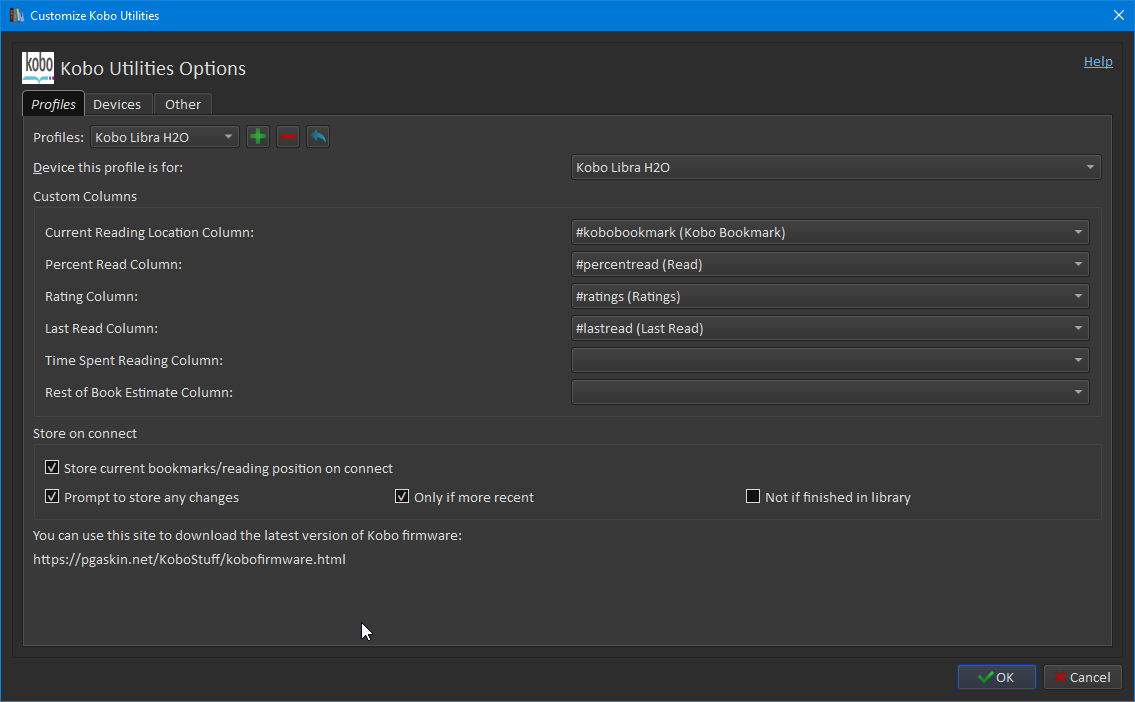

I install the plugin on 7.24.100 (preview). Got the same error.
calibre, version 7.24.100
ERROR: Unhandled exception: <b>ValueError</b>:too many values to unpack (expected 4)
calibre 7.24.100  embedded-python: True
Windows-10-10.0.19045-SP0 Windows ('64bit', 'WindowsPE')
('Windows', '10', '10.0.19045')
Python 3.11.5
Windows: ('10', '10.0.19045', 'SP0', 'Multiprocessor Free')
Interface language: None
EXE path: C:\Program Files\Calibre2\calibre.exe
Successfully initialized third party plugins: ...
  File "calibre\gui2\__init__.py", line 810, in dispatch
  File "calibre_plugins.koboutilities.action", line 2911, in _store_completed
  File "calibre_plugins.koboutilities.dialogs", line 3752, in __init__
  File "calibre_plugins.koboutilities.dialogs", line 3797, in initialize_controls
  File "calibre_plugins.koboutilities.dialogs", line 3880, in __init__
ValueError: too many values to unpack (expected 4)
Name:	2025-01-19 18_44_41-Customize Kobo Utilities.png

Thanks for the reports. Here is a new version with the following changes:
  • Fixed the exception reported above. I missed a few calls in the reading position dialog since I haven't used it myself, and the way the dialog code works the call sites didn't show up for me in a search for callers of the function I changed for the additional columns.
  • Fixed the issue that @ownedbycats reported, where unchecking a book in the reading position dialog didn't work.
  • There is now no dialog popup if there are no reading position changes, even if you have enabled the "Prompt for changes" option.
I hope this takes care of the important issues that are relevant for a new release.

Yes, now imports as expected. The other issues are fixed too.
