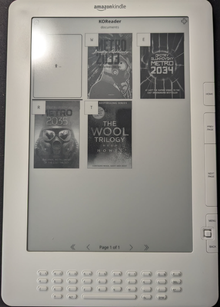

it is December 2024 and I ordered Kindle DX from eBay.
My goal was to install KoReader on this device.
Because this is very old device there are several hoops one will need to overcome to get this one setup in 2025
My device is B004 version and I did backup the os 2.5.8 and have rootfs.img and update_restore-os.bin available if somebody needs it.
This guide also applies to Kindle 2/dx/dxg
I will not explain every detail of the process, just read READ ME. Objective is to highlight obstacles and summarize resources to get this job done quicker.

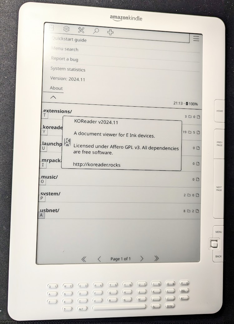

Finally install KoReader
https://github.com/koreader/koreader
use the legacy version: koreader-kindle-legacy-v2024.11.zip
The KOReader is 2025 app operating on 18 years old CPU. It is not going to be fast as Scribe. But after initial setup of KOReader you are down to turning pages and that works OK.
ID:	212557   Click image for larger version
Name:	Screenshot 2024-12-18 213246.png
ID:	212558   Click image for larger version
