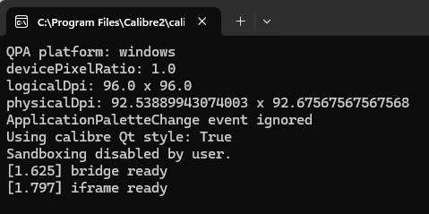

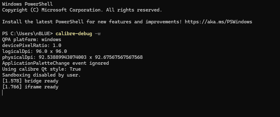

The run the viewer in debug mode from a command prompt as
calibre-debug -w
post the output
I don't know how to get to the basic c prompt. Tried typing calibre-debug -w in the "Run" window and in the app, "Terminal". Neither opened Calibre. Screen shots attached.
ID:	210669   Click image for larger version
Did you do this?
First, reboot in safe mode and see if your files open there.
