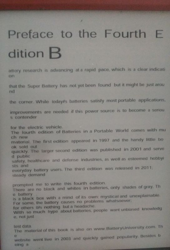

I'm struggling at getting k2 to convert a searchable PDF to something that displays on my reader as well as it does on the computer. For some reason, the output has carriage returns in the middle, along with garbage characters like #, and the font size changes occasionally. Unreadable.
I'm suprised since the doco says that by default, k2 converts PDFs to bitmaps so the output should be clean without having anything fancier to do than this:
k2pdfopt.exe -w 758 -h 1024 input.pdf
Edit: Using the GUI, I found that the solution is to keep the "Re-flow text" unchecked (default: -fc- -wrap-), which looks better than checking that option (-fc- -wrap+)… and way better than the options I tried through the CLI after reading the list of options availables.
Edit: False hope. I tried again, and for some reason, I get crap, with or without the wrap option (-fc- -wrap-, -fc- -wrap+). I don't get it.
Edit: As a work-around, I convert the PDF into PNG, merge them back into a PDF, and run it through k2

Still worth it because, like the help page says, bitmaps are displayed faster than a native PDF, besides the optimized output for 6" readers.

Originally Posted by Shohreh View Post
However, I'm having a problem with inputs that I ran through Abbyy Fine Reader:
- Saved as "searchable" PDF: The output from k2 inserts carriage returns about half-way through each line
- Saved as "image" PDF: I only get empty pages.
I cannot reproduce what you describe. Are you running k2pdfopt v2.55 on Windows. I've attached a couple of pages of output from your 2nd and 3rd commands (I added -p 1-2 to them). They all look the same. Is it only on your e-reader that the PDFs display funny? I'm just looking at these using Sumatra PDF on my desktop PC. There's really no way k2pdfopt can be inserting a carriage return in "fitwidth" mode. It's just adding commands to the source PDF to display different cropped regions of the source content on each page. It's not doing any text re-flow. I'm guessing this is an artifact of whatever reader you are using.
BTW, you used # for comments in your command list, so clearly you're not running them in a .bat file. What shell are you using?

Thansk for the help.
Yes.
Indeed, I now suspect it's just my cheap and older 6" reader whose PDF reader isn't up to par. I don't have another e-reader to check. The k2 output looks fine on SumatraPDF.
Plain Windows. The # were just to show they're comments :-)
Since then, I noticed Abbyy Finereader can convert a PDF to EPUB… with amazing result.
For "bitmap PDFs" that also contain an OCR layer , I'll just have to find a good English/French spellchecker to fix the few typos in the HTML files in the EPUB output.
Shohreh is offline   Reply With Quote

My pdf has page numbers and chapter names in the headers that I would like to keep at the top of the page, but no matter what options I choose, I get stuff like this:
This was output just in default mode with my Paperwhite SE dimensions as -h and -w. I made sure to use -pb+. I can't remember whether I had -as enabled, but I don't think that should affect this. My understanding is that -pb+ should be inserting a page break between (for example) the end of page 16 and the header on page 17, which you can see right in the middle of the page.
I've also tried using the calibre plugin interface with no success. Please help!
Sorry, link issue. See image here:

If I'm interpreting correctly, you want to put each source page header at the top of each destination page--basically you want to preserve page headers/footers. I don't recall anybody ever asking for that before, surprisingly (because it's a very reasonable ask). Presently there is no way to do that with k2pdfopt. I'll add it to my feature request list, but I haven't had time to do a major update in quite a while.
