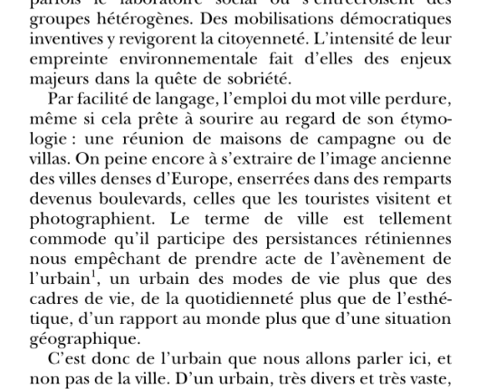

I find sans serif fonts easier to read on my e-reader.
Unless I missed it, it looks like k2 doesn't support setting the fonts in the output.
Is there a utility that can replace them in the input file?
For instance, here are the fonts in a book I'm currently reading:
.SFNS-Regular_wdth_opsz110000_GRAD_wght (TrueType; embedded)
.SFNS-Regular_wdth_opsz110000_GRAD_wght (TrueType; Roman; embedded)
Alegreya-Regular (TrueType; Roman; embedded)
Thank you.

It is generally a bad idea to replace the fonts in a PDF. When the PDF is constructed, the characters are precisely positioned (i.e. kerned) according to their shapes in the original font. If you change the font, then you get weird spacings between the characters in words (some have bigger gaps, others overlap). It just looks bad.
EPUBs are rendered completely differently from PDFs. There is no kerning information in EPUBs, so swapping fonts doesn't lead to weird character spacing.

My pdf has page numbers and chapter names in the headers that I would like to keep at the top of the page, but no matter what options I choose, I get stuff like this:
This was output just in default mode with my Paperwhite SE dimensions as -h and -w. I made sure to use -pb+. I can't remember whether I had -as enabled, but I don't think that should affect this. My understanding is that -pb+ should be inserting a page break between (for example) the end of page 16 and the header on page 17, which you can see right in the middle of the page.
I've also tried using the calibre plugin interface with no success. Please help!
Sorry, link issue. See image here:
Name:	7A62Oo2 - Imgur.jpg
