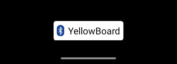

That's strange.
I have foot pedals, keyboards and clickers and I never touch a power switch.
I just hit some key and within two seconds it connects.
Ok, I'm on Android, I have my own popup that shows BT appearing and disappearing.
Does the Kobo give you any indication that something connected?
