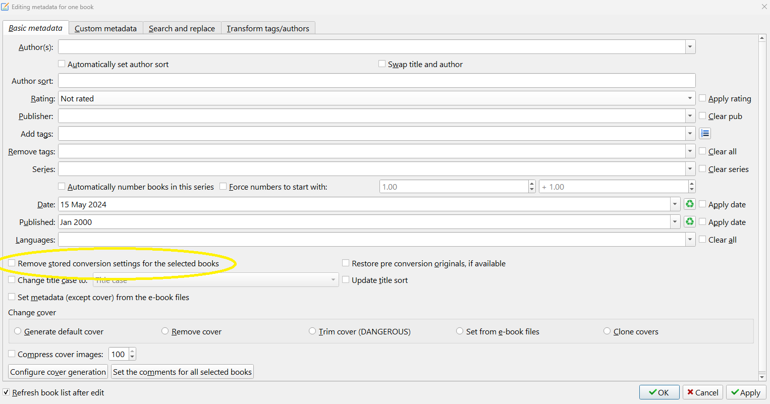

Once you have converted a file, it has a stored list of the conversion options and you will need to remove those before any changes will be applied. You can do this from the Edit metadata in bulk dialog. See the Remove stored conversion settings for the selected books item in the attached image. Every so often, I will select all the books in my library and apply that action.

Name:	Screenshot 2024-05-15 095505.png
