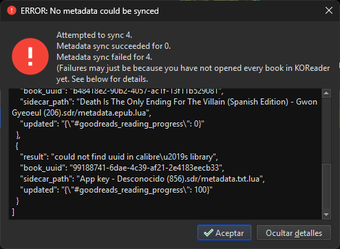

i'm having this problem
Name:	Captura de pantalla 2024-03-04 200821.png
ID:	206710   Click image for larger version
Name:	Captura de pantalla 2024-03-04 200835.png
ID:	206711   Click image for larger version
Name:	Captura de pantalla 2024-03-04 200845.png
Same. Trying to pull from a Kindle pw5
