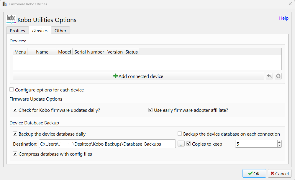

You can see in this picture that I've marked daily backup in a specific folder. The zip files that @theducks is mentioning are inside that folder. Inside of every zip folder there is a KoboReader.sqlite, that is the file you have to copy.
If you haven't checked the option for compressing altogether configuration files and database (whatever wording is in English), then you won't have inside a zip file, but only the KoboReader.sqlite (I guess renamed with a date that you have remove when you copy to Kobo).

Run calibre and open the Kobo Utilities configuration dialog (Customize plugin on the dropdown menu). Click on the second tab and configure the database backup. I've attached an image of my database backup setup.
Your manual database backup can also be used by copying it back to the .kobo directory but I prefer the automated solution.

This has been a very helpful thread. I now know that the ONLY way to get a full backup is to configure the settings in Kobo Utlities first. Simply gonig through the menu and selecting "Database>backup database does not work. It does create an sqlite file, the size indicates it most likely IS a copy of the KoboReader.sqlite on the device, but it does not even NAME it, at all. It also does not copy any config files. Had I not started this thread I wouls have gone on virtuously creating "backup" files that were effectively useless.

The issue is that the OP was using the Backup device database option under Database in Kobo Utilities menu. You need to supply the name (similar to the OP, I used names similar "KoboReader-2024-01-03" as the filename (the .sqlite was automatically appended) the few times I used that facility).
This is not the same as the Device Database Backup configured under the Kobo Utilities configuration being intended more for one shot backups before davidfor tested a database modification.
Thanks for this extra clarification of the different intended purpose of the two backup options. Now that I know the difference, the bility to save device specific backups is great - previously I only had 1 device to backup anyway
