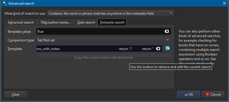

Here is something that works for me.
The template:
python:
def evaluate(book, context):
	db = context.db.new_api
	items_with_notes = context.globals.get('items_with_notes')
	if items_with_notes is None:
		items_with_notes = db.get_all_items_that_have_notes('authors')
		context.globals['items_with_notes'] = items_with_notes
	for aut in book.authors:
		if db.get_item_id('authors', aut) in items_with_notes:
			return '1'
	return ''
You set which category you are interested in by changing 'authors' to the category name of interest, e.g., tags.
The template search is:
EDIT: This template is slow. See the template in post #10.

That one halts Calibre, for me. Additionally, I notice that the "Copy current search..." button doesn't get enabled for me, so I may be doing something wrong:
Name:	MWSnap 2023-12-16, 16_34_30.png
What do you mean by "halts calibre"? How long did you let it run? You might try it on a smaller virtual library to see if there is a performance problem, although I did run it on a 50,000 book library with no problems.
