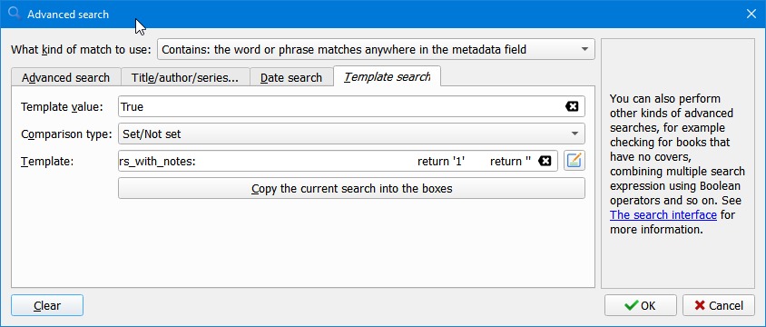

The template search is:
EDIT: This template is slow. See the template in post #10.

That one halts Calibre, for me. Additionally, I notice that the "Copy current search..." button doesn't get enabled for me, so I may be doing something wrong:

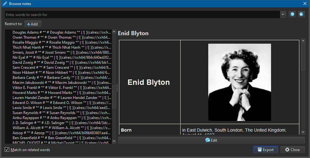

On another note, I find that the output generated by the GR Author Notes plugin show up a bit garbled in the Notes Browser, not sure if that's expected:
What do you mean by "halts calibre"? How long did you let it run? You might try it on a smaller virtual library to see if there is a performance problem, although I did run it on a 50,000 book library with no problems.
