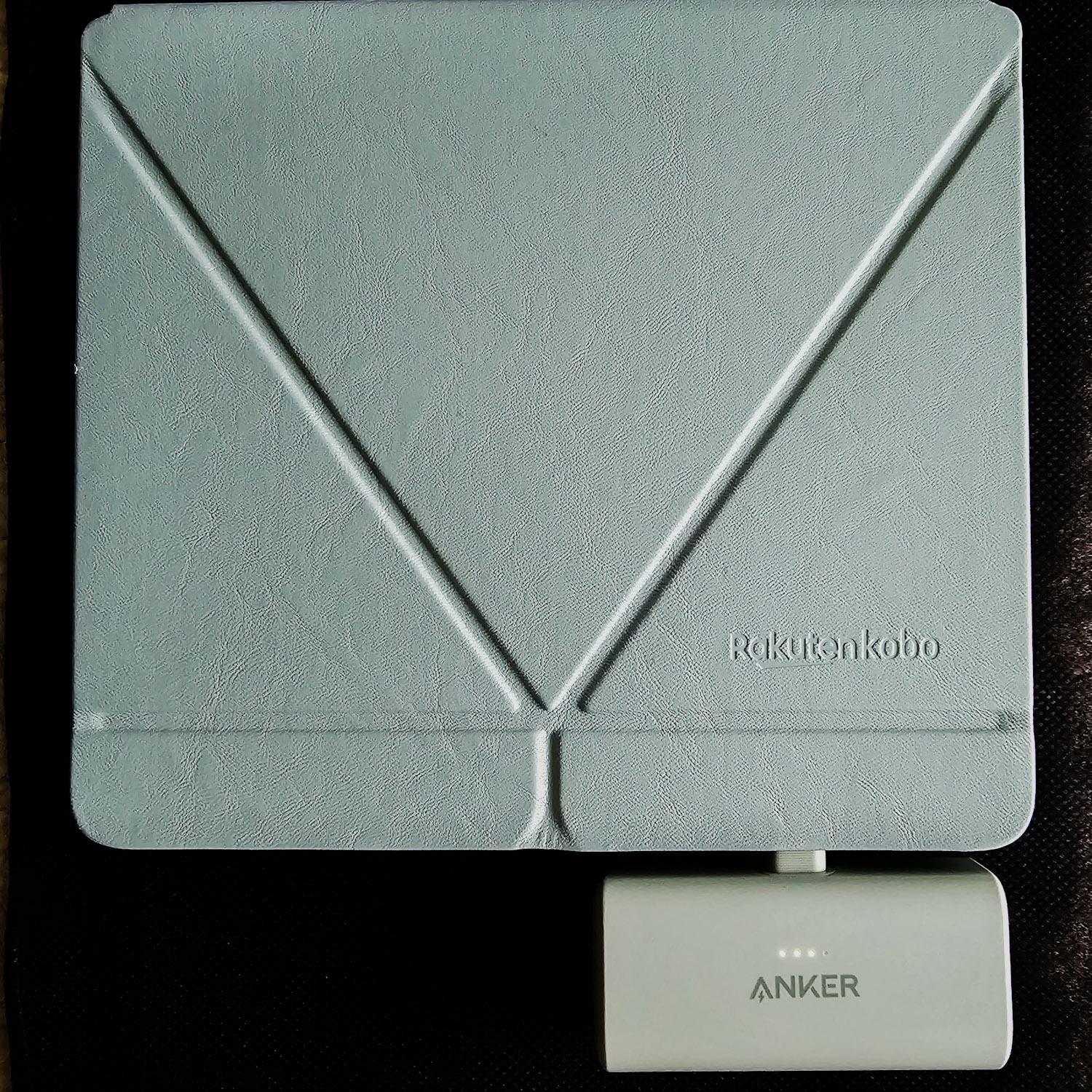

I use this Anker mini-bank for my Sage OTG (or any ereader/small device). No cables, no wireless pad, no fuss. Built-in, foldable, flush USB-C fits in a small pocket. Multiple colors to match Kobo's OEM covers:
ID:	205156   Click image for larger version
