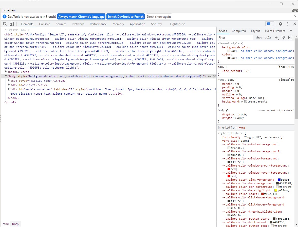

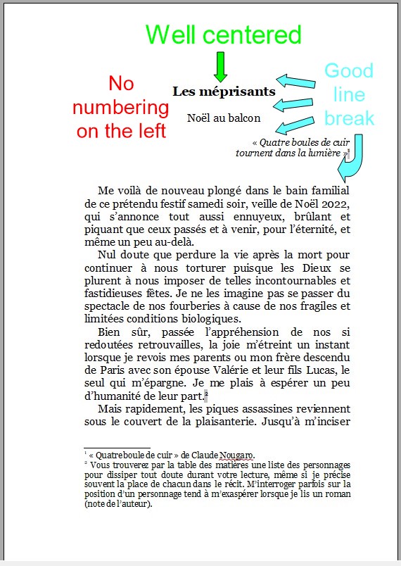

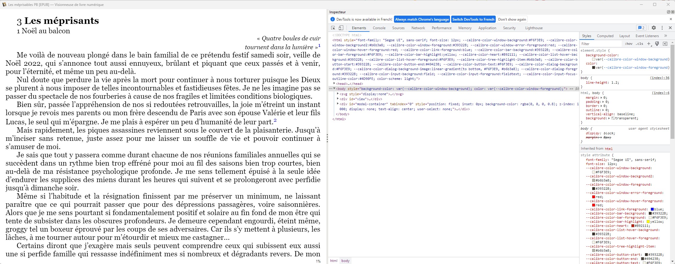

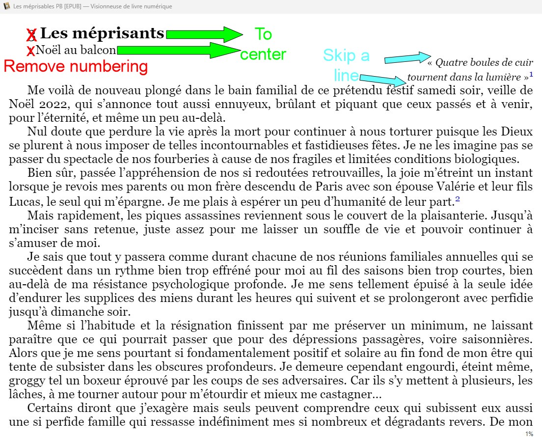

Hello
Here are some screenshots to give you an idea of ​​my problems.
1) what I see in the .odt or .docx file to create the ePub
(of course different from the paper version of the book)
with some details in colors in red, green and blue :
2) How it appears in the ePub on the left with the code on the right :
3) detail of the left part of the 2nd photo
always with color details of what I want:
4) detail of the right part of the code in the 2nd photo :
Can you help me with these photos?
Thanks.
Thierry
Last edited by issybird; 10-07-2023 at 08:27 PM. Reason: Colossal images thumbnailed. Please read the guidelines for limits on image size before posting again.

Karellen
Karellen's Avatar
Posts: 1,689
Karma: 9500498
Join Date: Sep 2021
Location: Australia
Short answer is No.
We can't see all the code and I think you are showing us the viewer code, not the epub code. We need the epub file.
Also, use the paperclip icon in the editors bar to upload images. Press "Go Advanced" if you don't see that.
Karellen is online now   Reply With Quote

Old 10-07-2023, 09:24 PM   #15
Posts: 48,276
Karma: 174315444
If nothing else, get rid of those styles stuffed into the <html> and <body> tag. In line styles are very seldom a good idea and make a total pain of trying to edit styles.
From Libre Office, save the document as a docx. calibre handles docx much better than odt.
I would recommend attaching the epub to a message here after using the Scramble plugin.
