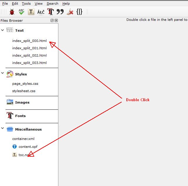

Double click a file in Files Browser - if you can't see the Files Browser try Ctrl+Alt+F

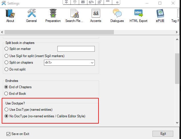

@jpomart - another long-shot tangent. There's a widely used Word add-in that creates EPUBs from Word documents - it has these options - no idea of there significance or if its relevant to the reader -as I don't use that bit of add in.

The tool BetterRed mentioned is by toxaris. See e-Book Tools - a Word add-in
Old 12-10-2015, 04:20 PM   #11
Posts: 22,901
Karma: 34252744
@jpomart - apologies for confusing you - my reference to those settings in the Word add-in was intended as a hint to the other aficionados - IIRC those two radio buttons are used to create Sigil and Calibre 'compatible' code - something to do with entities. But it was another existentialist red herring
