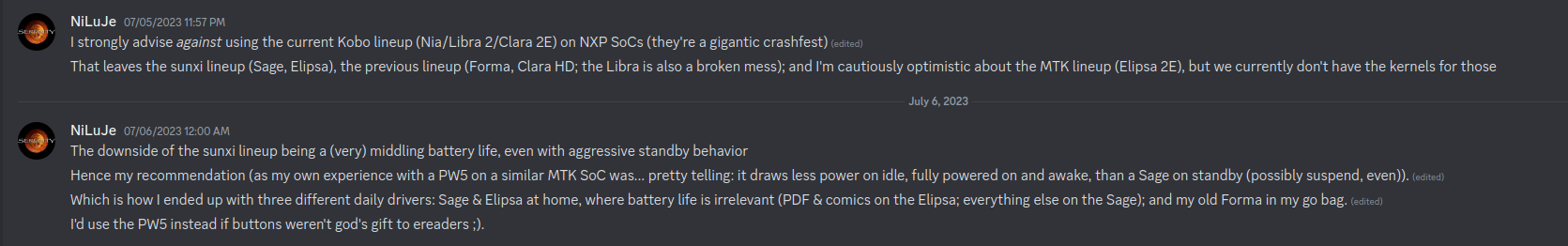

A Sage will do just fine, but if you're not in any hurry, I'd wait for its successor.
