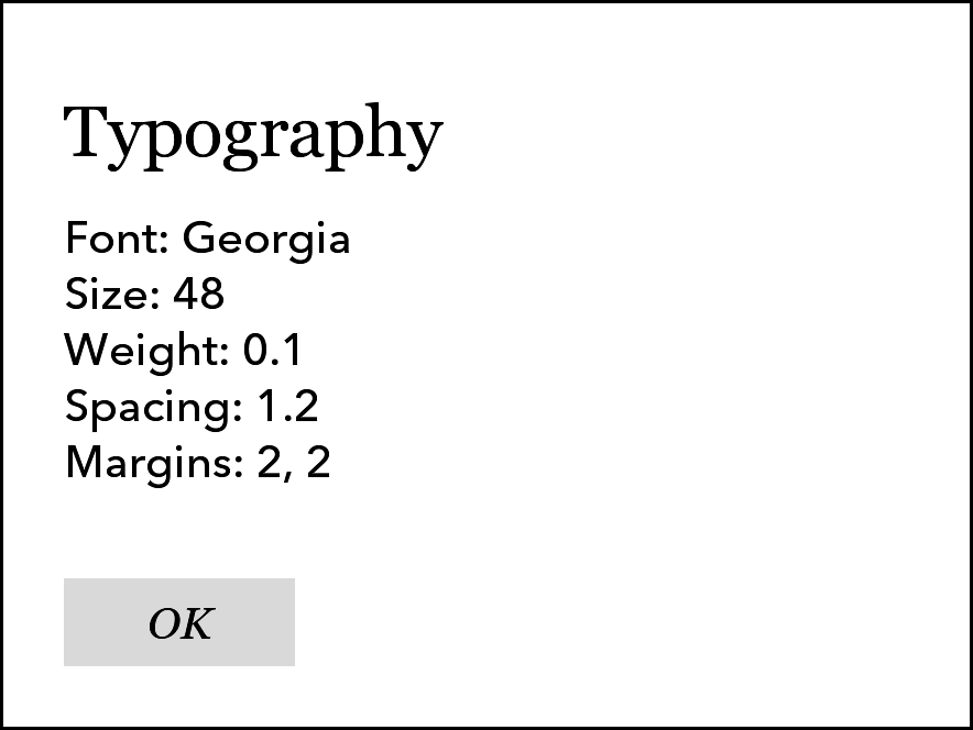

I got tired of the way the font menu has sliders that give no indication of what the actual values are for each font setting, so I wrote a small script to gather this information from Kobo eReader.conf. Note that your font settings are saved across books, and changing books does not immediately update the contents of Kobo eReader.conf, so the script may provide outdated information if you switch between books and then invoke the script before using the font menu to adjust anything.
A screenshot of the script output is attached below.
Thanks for your sample code. My own shell script skills are practically non-existent, but a bit of grep/cut googling helped me understand what you did.
I just thought I'd mention that you may need to revisit the code for FontWeight. The .conf file can contain many of these lines, one per font-family that you've ever adjusted the weight for. e.g.
[Reading]
readingFontWeight\Georgia=0.19
readingFontWeight\IBM%20Plex%20Serif=0.63
readingFontWeight\Kobo%20Nickel=0.48
readingFontWeight\Libre%20Baskerville=0.8
readingFontWeight\LinuxLibertineG=0.65
So if you only want to show the weight of the currently selected font family then you'd need to include the current value of readingFontFamily in your search term.
P.S. Weight isn't a value I'm particularly interested in seeing, so please don't do any extra work on my behalf.

Yes, this works, but the Weight line in the output popup contains a number for each font weight present in the .conf file. In my case, there are 10 weight values on one line, each separated by a space.
The numbers are the weights of each font in alphabetical order as they appear in the .conf file.

Interesting! I only read in Georgia, so I didn't know the configuration file would store weights for each font face. That seems like an odd choice to me, since it doesn't store the font size on a per-font basis. The quick and dirty solution is to either not parse the weight at all or to delete all of the extra weight lines from the configuration file and only keep the one for the font you actually read in. You can still change the font face, as the extra weight entries won't get created again unless you adjust the weight of the other fonts.
