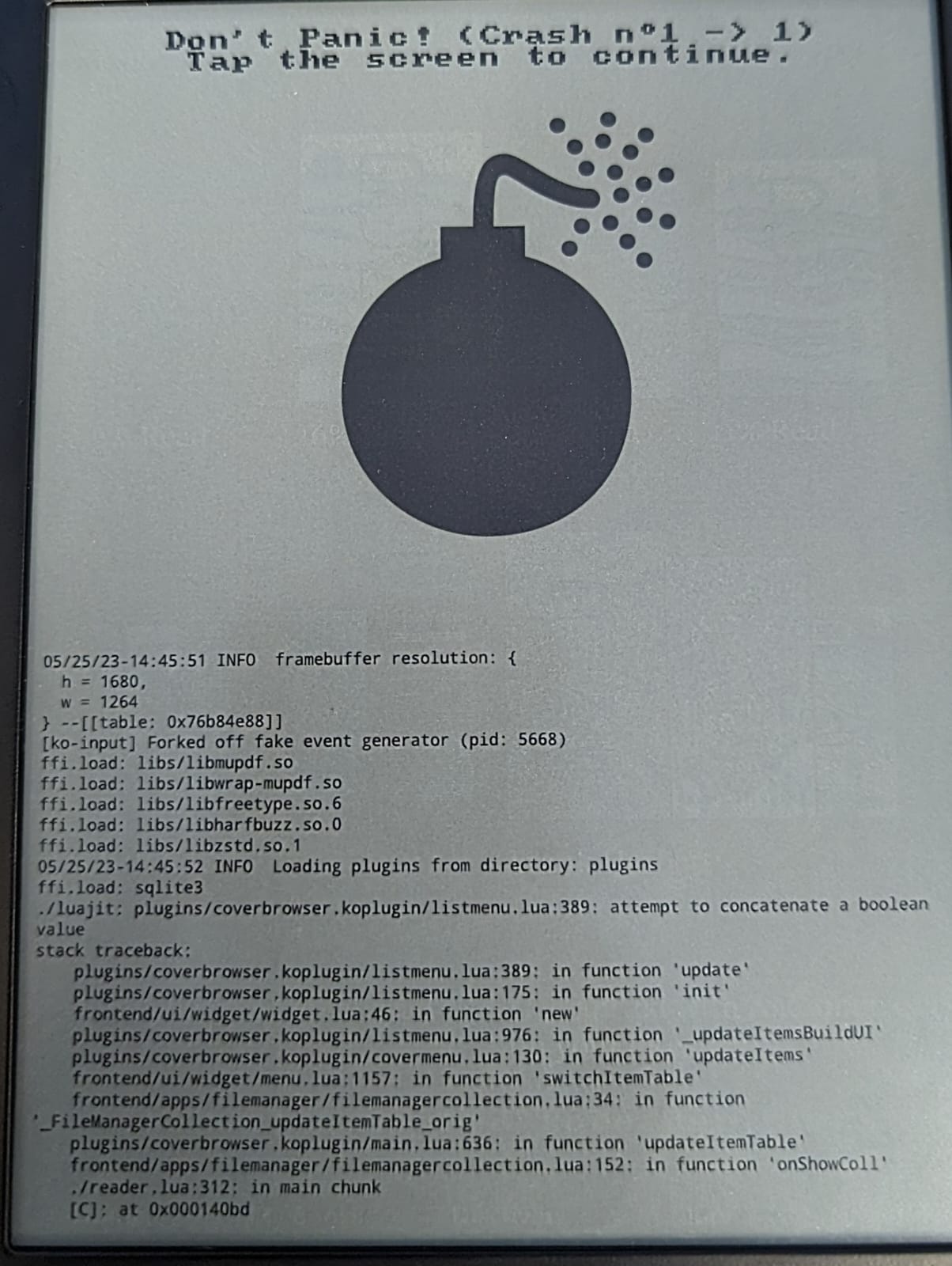

Old 05-25-2023, 03:52 PM   #919
favero_
favero_ began at the beginning.
Posts: 35
Join Date: Jul 2017
Device: Kindle Paperwhite 3
Hi!
After connecting my Kobo Libra 2 to my computer and transfering a book through Calibre (as I had done several times before), Koreader crashed and I can't make it work again. I tried to reinstall it through the one-click app, but with no luck. Attached is the image of the error.
If there was a way to correct this without losing my koreader metadata, I'd really appreciate it!
Thanks,
Name:	WhatsApp Image 2023-05-25 at 14.46.56.jpeg
favero_ is offline   Reply With Quote

Originally Posted by favero_ View Post
Hi!
Thanks,
Never mind, I figured it out: I had deleted a book that was in my favorites, and the reader was set to boot in the favorites page. So I guess it couldn't boot because it couldn't find one of the books. Putting it back in the e-reader solved it.
Are you on the latest stable or nightly?
IIRC, we used to handle that sanely (at least for last opened, maybe not favs), so I do consider that as a bug. A crash is not nice .
I don't know how to report this then
I did that for you yesterday, and @hius07 jumped on it and fixed it .
https://github.com/koreader/koreader/pull/10488
