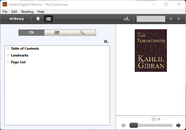

Both ADE 2.0.1.78765 and ADE 4.5.11.187303 for Windows render covers in EPUB2 books with the default SVG cover code fine.
(I used this MR book for the test.)
Cover code:
        <div>
            <svg xmlns="http://www.w3.org/2000/svg" xmlns:xlink="http://www.w3.org/1999/xlink" version="1.1" width="100%" height="100%" viewBox="0 0 563 751" preserveAspectRatio="none">
                <image width="563" height="751" xlink:href="cover.jpeg"/>
            </svg>
        </div>
However, the cover of this epub3 MR book was not correctly rendered in ADE 4.5.11. (It was rendered fine in ADE 2.0.1.)
Cover code:
  <div style="text-align: center; padding: 0pt; margin: 0pt;">
    <svg xmlns="http://www.w3.org/2000/svg" height="100%" width="100%" version="1.1" preserveAspectRatio="xMidYMid meet" xmlns:xlink="http://www.w3.org/1999/xlink" viewBox="0 0 1080 1430"><image width="1080" xlink:href="../Images/cover.jpg" height="1430"/></svg>
  </div>
After implementing the change recommended by elibrarian, the cover was correctly rendered.
(I used height:100vh; instead of height:98vh;)
  <div style="height:100vh; text-align: center; padding: 0pt; margin: 0pt;">
  </div>

So the exact same version of ADE 4.5.11.187303 on Windows works fine for epub2 with 100% but not for epub3? Or did I misread and you tested with a slightly different build number?
  </div>
And your version of the workaround of setting the height on the parent div really makes sense as its svg child should use 100% of that height.
Sigil does have epub version specific code for the cover so adding that workaround to the epub3 version is easily doable.
