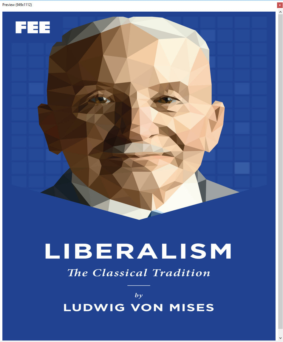

What is the benefit of wrapping a cover jpg (or any image) in SVG code? I've seen ebooks with cover images without SVG; and other ebooks wrap the cover jpg in SVG. SVG also seems to be the default for Sigil and Calibre.
As others have mentioned, the SVG Wrapper allows the underlying image to stretch/expand without distortion.
This differences really stand out when you have Tall/Skinny or Fat/Short images, OR you turn your device from Portrait->Landscape.
For example:
Example 1 (SVG Wrapper vs. HTML Width) [Portrait]
You can see the SVG Wrapper stays the proper ratio:
but the HTML version that stretches to "100% width/height of the screen" starts turning into an oompa loompa:

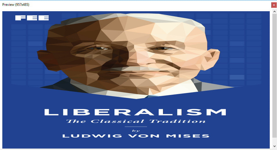

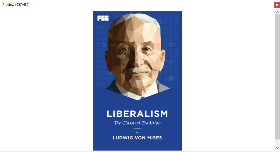

Example 2 (SVG Wrapper vs. HTML Width) [Landscape]
The problem becomes much worse when you turn the device to landscape.
You can see the SVG Wrapper keeps the ratio correct:
but the HTML Width+Height version gets severely distorted:
