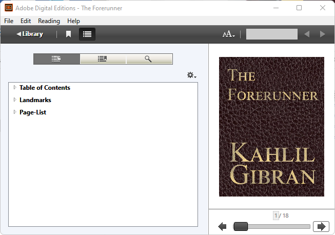

If anyone has Adobe Digital Editions versions on their machines could they please test the use of "100%" for width and height in an svg cover versus "100vw" for width and "100vh" for height (or 98 or 95 or ...). And report back.
Both ADE 2.0.1.78765 and ADE 4.5.11.187303 for Windows render covers in EPUB2 books with the default SVG cover code fine.
(I used this MR book for the test.)
Cover code:
        <div>
            <svg xmlns="http://www.w3.org/2000/svg" xmlns:xlink="http://www.w3.org/1999/xlink" version="1.1" width="100%" height="100%" viewBox="0 0 563 751" preserveAspectRatio="none">
                <image width="563" height="751" xlink:href="cover.jpeg"/>
            </svg>
        </div>
However, the cover of this epub3 MR book was not correctly rendered in ADE 4.5.11. (It was rendered fine in ADE 2.0.1.)
Cover code:
  <div style="text-align: center; padding: 0pt; margin: 0pt;">
    <svg xmlns="http://www.w3.org/2000/svg" height="100%" width="100%" version="1.1" preserveAspectRatio="xMidYMid meet" xmlns:xlink="http://www.w3.org/1999/xlink" viewBox="0 0 1080 1430"><image width="1080" xlink:href="../Images/cover.jpg" height="1430"/></svg>
  </div>
After implementing the change recommended by elibrarian, the cover was correctly rendered.
(I used height:100vh; instead of height:98vh;)
  <div style="height:100vh; text-align: center; padding: 0pt; margin: 0pt;">
  </div>

So the exact same version of ADE 4.5.11.187303 on Windows works fine for epub2 with 100% but not for epub3? Or did I misread and you tested with a slightly different build number?
  </div>
And your version of the workaround of setting the height on the parent div really makes sense as its svg child should use 100% of that height.
Sigil does have epub version specific code for the cover so adding that workaround to the epub3 version is easily doable.
