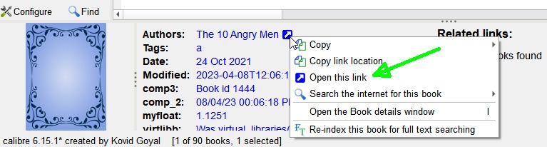

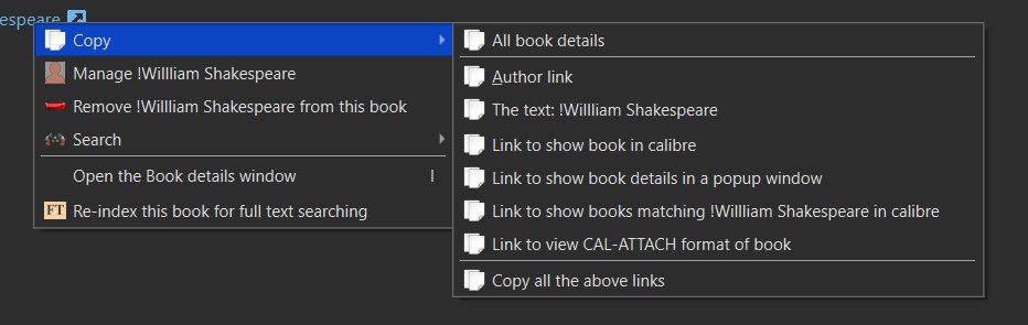

Also, another thing that I just thought of:
My hands are a bit wobbly rright now, so three times in a row I accidentally right-clicked the entry name instead of the external-link glyph (it's a small tatrget).
If possible, perhaps add 'Copy > Link associated with entry' (naming it that to make it distinct from calibre:// search links) to the context menu of the entry.
This might be better

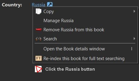

In fact I'd like it too, but put it the outer context menu - the Copy sub-menu is crowded enough, especially if there are multiple format files.
Name:	Screenshot 2023-04-09 111537.jpg
Why is FTS book reindexing in every category context menu, and not just once in the book list context menu ?
Attachment 200892
if it were up to me, the only place I'd put the index option is in the format context menu -- the main use for it seems to be when the files are edited externally so that Calibre can't detect it (and you probably wouldn't be doing
btw, I read !William Shakespeare as "Not William Shakespeare" and was confused until I realized more likely putting it at the beginning of lists
I added it to the context menu for the link itself so you can use right-click then "Click" to use the link. This is in calibre source.
I am looking at adding it to the context menu of the associated item. This isn't completely straightforward.
