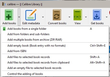

Old 07-08-2021, 01:23 AM   #3
detourx
detourx began at the beginning.
Posts: 6
Join Date: Jul 2021
Device: Calibre

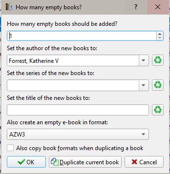

Right click the add books button and choose "add empty book"
Thank you for the reply but this doesn't appear to work. There are other options after choosing "Add empty book" ('Book entry with no formats') and then the next pop-up doesn't say where I can add a synopsis. Choosing any of those options creates an 'empty book'. Very confusing.

Old 07-08-2021, 01:29 AM   #4
Posts: 46,580
Karma: 29634066
Add the synopsis to the empty book by using the edit metadata button.
Old 07-08-2021, 01:31 AM   #5
davidfor
Posts: 24,905
Karma: 47303828
Location: Sydney, Australia
Press the "OK" button to create the book. Then open the metadata editor for the book. That has a field called "Comments". This is usually used for the synopsis. If you are adding an ebook with metadata containing a synopsis, it will be put into this field.
