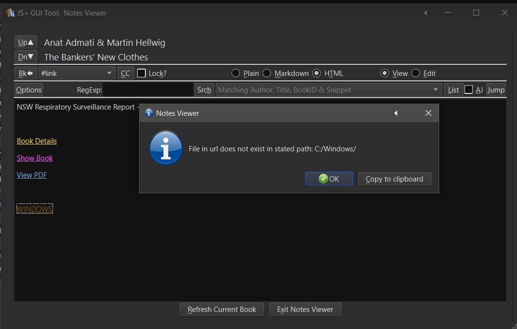

I found the hidden Easter egg, if you have an LT column with multiple links you can Tab/Backtab to them and press enter to get at them.
I also found that file:/// links to a folder don't work in NV, but they do in Book Details - it opens the folder in file explorer.
Name:	Screenshot 2023-04-08 100614.jpg
file:/// links to a file are fine - including to a windows shortcut to the folder. Bit ugly though, folder shortcuts inside the target folder was a kludge I used on my Heath Robinson library manager 20 years ago.

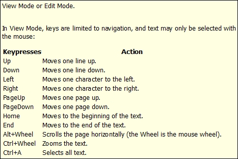

Added: How can I give focus to the note content widget from the keyboard?
Added 2: I'd rather the NV didn't close if I hit Escape.
[1] See the attached ToolTips for the Edit Mode label for the Edit radio-button. Focus only exists in Edit Mode. That is a Qt thing. You can use Tab to move the focus next to it, but not within it, in View Mode.
[2] Escape natively closes all Qt Widgets; that is a Qt thing that I also dislike.
DaltonST

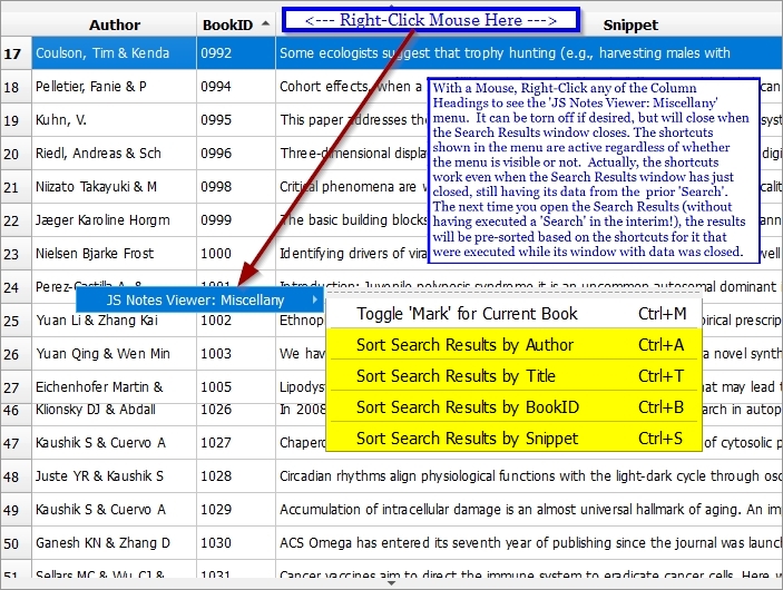

Version 1.0.228 Notes Viewer: Various enhancements
Version 1.0.228 -2023-04-07 Notes Viewer: Various enhancements. Refer to the attached images for details.
DaltonST
ID:	200858   Click image for larger version

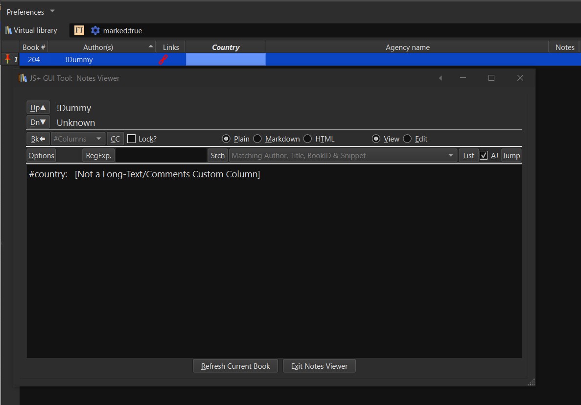

Why does NV react to what I do in the book list, viz:
Name:	Screenshot 2023-04-08 163002.jpg
Country is a Text like tags column.
Attachment 200861
NV is joined at the hip with the Library View. Its driver is a Library View event that is emitted whenever the current cell changes.
self.maingui.library_view.selectionModel().currentChanged.connect(self.refresh_notes_viewer)
I will take your question as an indication that NV is very non-mouse-user friendly. That question would never occur to a pure mouse-user, like myself, who doesn't use shortcuts.
DaltonST

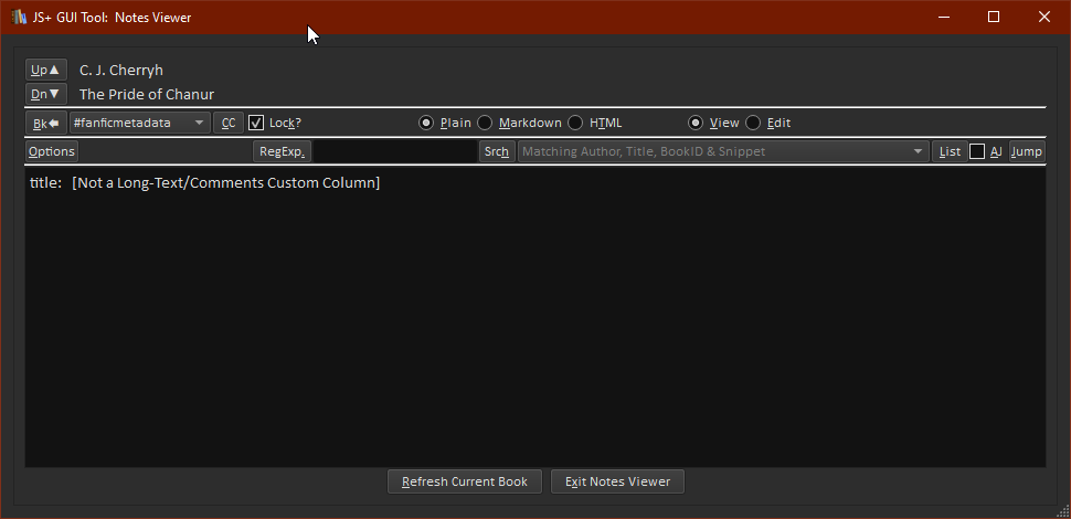

Small visual bug:
1. Open NV with a default selected column. Make sure 'lock?' is disabled.
2. Click on another cell in the book list to load that cell.
3. Click 'Lock?'
4. Use the dropdown menu to select a column.
Expected behaviours:
1. The dropdown menu will be disabled if the column is locked.
2. If the dropdown menu is enabled, it will change the displayed column even if locked.
Actual result:
Changing the column with the dropdown menu does not change the displayed one.
Name:	2023-04-08 15_14_28-JS+ GUI Tool_  Notes Viewer.png
Old 04-08-2023, 02:31 PM   #1004
DaltonST
Deviser
DaltonST's Avatar
Posts: 2,265
Karma: 2090983
Join Date: Aug 2013
Location: Texas
Small visual bug:
3. Click 'Lock?'
Actual result:
So, you Locked the column while NV was still focused on Title? And then changed the column in the dropdown to #fanficmetadata?
"Lock" means "Lock here, starting right now". "Lock" does not mean "auto-jump to the next new dropdown #column I pick". It simply locked where you were when you clicked "Lock". It just so happened it was not where you wanted to be.
The proper sequence is to have changed the column to #fanficmetadata and then Locked. The changing of the column to #fanficmetadata itself would have caused an immediate "auto-jump" by NV to #fanficmetadata, but that normal auto-jump was blocked by the premature Lock.
Not a bug. User error.
DaltonST
