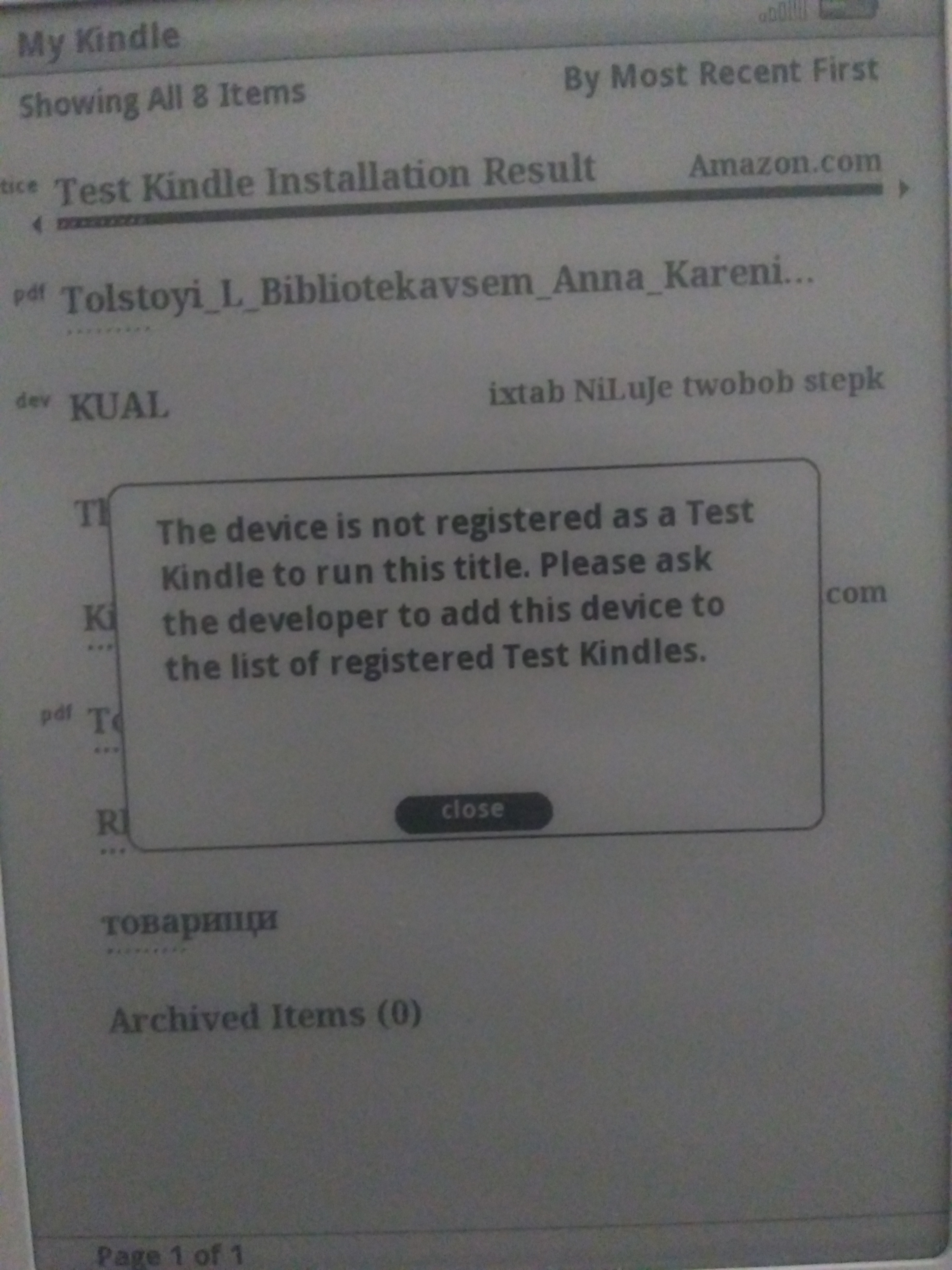

I understood it, I made the koul shell, but it does not start, I did it according to the instructions from this forum

We advise to read the instructions carefully and to gain a better grasp of what hacks and tools are for which generation of Kindle models and firmware branches.
Originally Posted by KUAL instructions
As pretty much anything here, your device will need to be jailbroken. Please refer to the wiki and/or the stickies & index for the appropriate method for your specific Kindle model .
In addition, you may need to install MKK: if your device runs on FW 5.x, and you're using the K5 JB >= 1.11.N (or the associated "hotfix"), you don't need to do anything, MKK is bundled with your JB. If you're using an older device, you will need to install MKK yourself .
Finally, you need to install KUAL itself, by putting the appropriate azw2 file somewhere in the documents/ directory tree of your device.
First, download the latest KUAL archive from the Snapshots thread and unpack it. Then, if your device runs on FW 5.x, use the KUAL-KDK-2.0.azw2 file. If your device is older, use the KUAL-KDK-1.0.azw2 file.
So, you don't use KUAL booklet version on Kindle 2, you need to copy "KUAL-KDK-1.0.azw2" file into "documents" folder on your Kindle.
And you need to install "MKK" since that isn't included / bundled with Kindle 2 jailbreak.
MKK download link: https://storage.gra.cloud.ovh.net/v1...-r18833.tar.xz
KUAL download link:
https://storage.gra.cloud.ovh.net/v1...0221017.tar.xz

my k2 cdma device. the last photo shows that all these files have been installed, my device still says that I am not a developer and cannot run the kual shell
