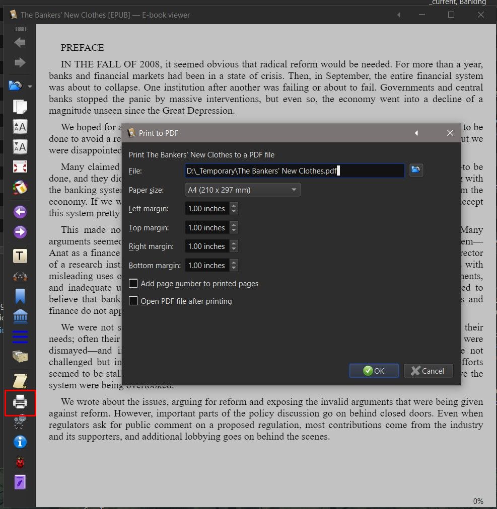

@TTimeTraveller: if it looks okay in the viewer try printing from there -- it creates a PDF.
Name:	Screenshot 2023-03-02 204549.jpg
Attachment 200051
That works but PDF is not useful in my situation.
