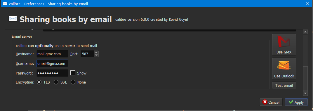

Old 11-22-2022, 11:21 AM   #27
Comfy.n
want to learn what I want
Posts: 1,713
Karma: 7917125
Join Date: Sep 2020
this:
Preferences -> Sharing books by email > click Use GMX
Name:	MWSnap0880 2022-11-22, 12_18_56.png
Old 11-22-2022, 11:24 AM   #28
maudel
maudel began at the beginning.
Posts: 7
Join Date: Nov 2022
Device: Kindle Oasis
Thanks
