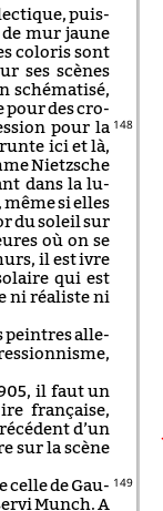

I have a question, do Plato shows real page numbers? i have used Koreader before but i dont like to have position numbers instead of real page number, so before i install Plato i want to know if plato show real page numbers?

I can't speak for Plato, but KOReader supports ePub 3 page maps (or whatever the thing is actually called, but it's what you're talking about) .

Noob question lol how do I use "epub3"" because as I have mentioned before, I don't like the fact that I load up a 128 pages book for example and then koreader shows like 300 page numbers

You'll have to figure out that one yourself, the ePub spec is a nightmare: https://w3c.github.io/epub-specs/epu...c-nav-pagelist

Posts: 81,554
Karma: 150265873
The Man Who Died Twice by Richard Osman
432 pages
448 pages
Both of those page number are correct for the pBook versions. That is because they are in different formats.
Your 300 pages is based on how many screens there are. That varies depending on your settings such as the font, font size. hyphenation, line height, margins, footer/header, etc.
The only way to have a consistent page number that ignores all of those things is to read your ePub in RMSDK on you Kobo and no KOReader or as KePub.

I don't have a Kobo since 2017 but IIRC the RMSDK shows the same kind of "real pages" like KOReader does (see attachment)
The only difference is that KOReader follows the spec and thus require a proper epub(3) that features that and Adobe does its nasty magic on all kind of epubs.
