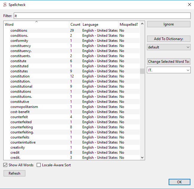

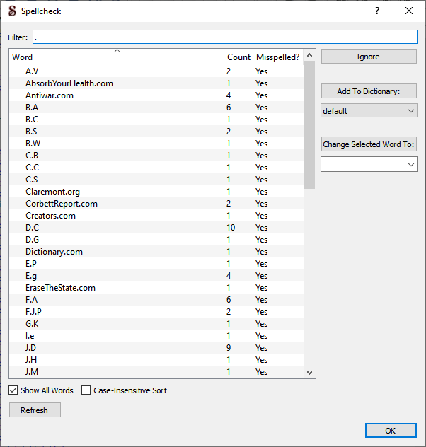

See some comparison images.
Before vs. After:
ID:	196177 Click image for larger version
ID:	196179 Click image for larger version
Much fewer words per screen, and near-words (or typos) get lost under all the "duplicate periods".
Plus, your eyes are always "stutter-stepping", because of the:
  • 1 character smaller
  • + 1 character bigger
    • Oh, great, another period...
When 99% of these extra "words" are duplicate periods... your brain turns off.
That's the major problems, as I see it, but I've got many other intermediate/smaller ones too.
Here's a few I picked out of the last book I worked on:
Problem #1: Indexes/PageNumbers (especially roman numerals)
Similar to Spellcheck Lists in Calibre getting flooded with numbers, this index/roman numeral issue also kicks it up to 1000!
You get hundreds and hundreds of extra:
i.
ii.
ix.
I.
II.
III.
clogging almost every single search—again, drowning out many of the otherwise at-a-glance issues.
Problem #2: URLs Lost
One trick I love/d to use is a period to find yet-to-be-linked URLs in a book:
ID:	196181 Click image for larger version
URLs are completely lost in Spellcheck Lists now.
Not just by (partial) acronyms but by every single sentence now too!

Old 08-31-2022, 06:07 AM   #9
DiapDealer
DiapDealer's Avatar
Posts: 29,235
Karma: 211539966
Yes, yes, I know.
But for a common user (like Mbear or GreggBell) to know where to dig and "fix this" and substitute with an old hunspell, it's just madness.
Put a foot in the normal human's shoes for a second
Ah... I feared it might be a "think of the children" thing.
But "madness"?? That's a tad extreme. The ability to add custom hunspell dictionaries has long been a feature of Sigil. Was it madness to offer that ability? Don't get hung up on needing to get an "old" hunspell dictionary. "Old" was in the sense that any version of Sigil previous to 1.9.1 would have one. ANY non-Sigil-1.9.1 hunspell dictionary will suffice. It doesn't need to be "old".

Just install any Hunspell en dictionary and the previous behaviour you want is restored. So no checkbox preferences or ui changes will be made. No editing of aff is needed. A dictionary that supports abbreviations and reduces spurious suggestions needs to be designed to do so. It uses different word lists. So using just a checkbox preference is not possible. But adding a hunspell dictionary is easily done by users.
Trying to misuse spellcheck to check for bad urls when a plugin exists to do that seems a bit over the top.
I will look into reordering the columns and right adjusting the counts, just NOT for the next release as that would entail large changes in the User Guide spellcheck related images when we are just about to make a new release.
Yes, adding the word to the dictionary will remove it sentence ending variant when a refresh is done.
So just install your own hunspell en dictionary into your Sigil Preferences and you will never have to live with it. I work on many math heavy papers typically loaded with abbreviations and acronyms but with very few or next to none proper first names. I like the hunspell dictionary I built to handle that aspect more correctly. If you do not like that behaviour simply install any english hunspell dictionary (newer or older) just once to get the behaviour you want.
And if you want to make accurate counts, I recommend using the new Saved Search Group Counts Report feature and not trying to use SpellCheck for that. It was added for just that purpose.
